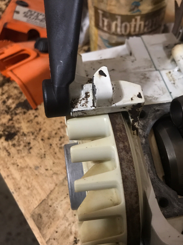

Working on a MS460, unfortunately the brake handle I ordered wasn’t described properly and was a MS440 brake handle. I’m going to get a new one at the dealer I guess. This should a very nice saw. Everything looks really good. Should be a good seller when I’m done with it.

I've usually not had any problems with the Asian 460 Brake Handles, but they get to you much faster if you find one that ships from within the States.
460 Handles are wider than 440 handles, but will work on a 440 if you space the left side out. They also provide a touch more clearance for the cylinder and muffler.
Is the one you have too narrow???

The one I have is too narrow,

I see a lot of the Ebay ones are described as both 440 + 460, which is BS, they are not the same, the 460 handle is wider. Don't see any reasonable priced shipping from the states, but if you order the Huztl one, they usually get it right and ship faster than some others.

The one I ordered said it was for a 046 or MS460 only. I contacted the seller telling them it wouldn’t fit. I may go the huztl route, because I am pretty sure they are $40 from Stihl.

That is what I would do.
Then, I would also tell the seller to replace the one he sent you and ask for return postage for the one you received. Often, they will just let you keep it as the return postage cost more than a new part.
A pic from another angle, with the starter installed, would help to detail the problem.
