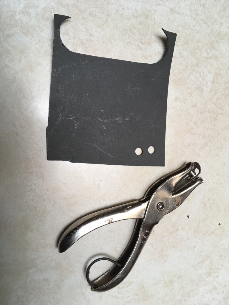

Governor eliminator.
Most any automotive gasket material can be used.
Cheerios box, not so much.

No, pin that lever rides on is staked into the round metering chamber cover. No spring in the kit either... Could use one of those also.
Yeah, I know what you're talking about now. The pin wouldn't be included nor would the spring. Zama is about the only company that includes the spring in their kits. I'm still thinking I've bought kits for those that included the metering lever. At any rate I'll look around and see what I have especially since I worked on a Super EZ yesterday and still have my parts strewn around the garage.

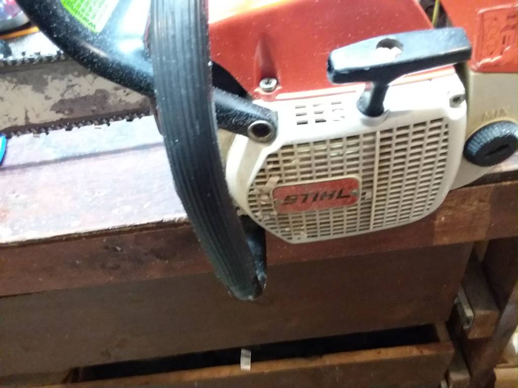

Got this old girl going today swapped in a new China carb and it was running very well. It was holding 9-10k in the cut on 10-12" ash.
Seems like a good runner
Sent from my SM-J327V using Tapatalk
Which carb did you use, and from where ?? Thx
