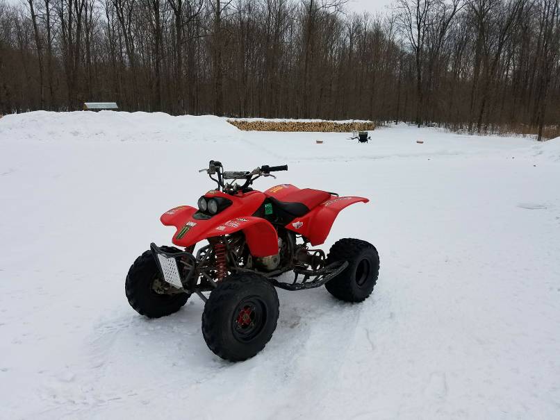

Good machine there. Owned one and built several motors.
It's a friend of my daughters.....been worked on by a bunch of kids. Now they can't get it to start. LOL
I told him to bring it over and I'll help him out.
I have no idea what I'm getting myself into. Until I really get I to it.

Check compression, if low it's most likely tight intake valves... A dirty or missing air filter the likely culprit...

Nothing real difficult there. Swingarm pivot bolt can be a royal PITA if it hasn't been maintained. Motors are pretty much bulletproof.
