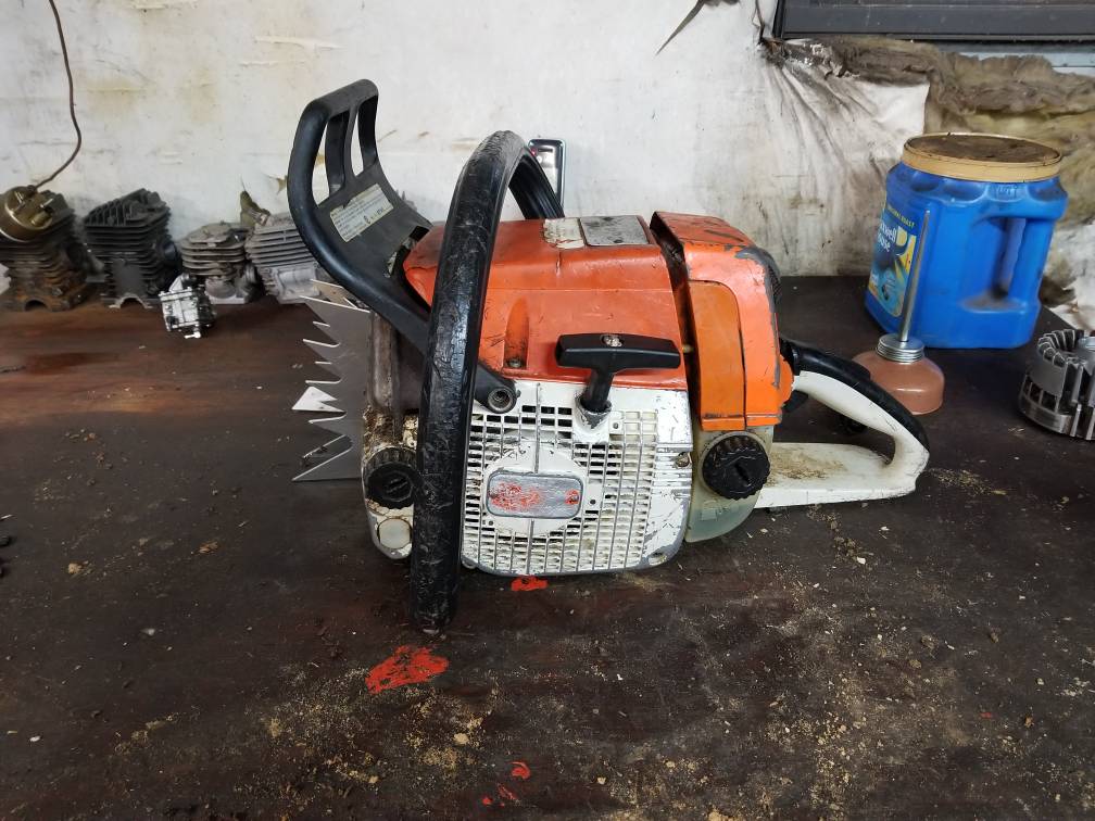

I think I finally have my 064 ready to work. It got a flywheel, coil, wire harness, brake handle,fuel lines, fuel filter, starter rope and handle, and most importantly aluminum bucking spikes.
