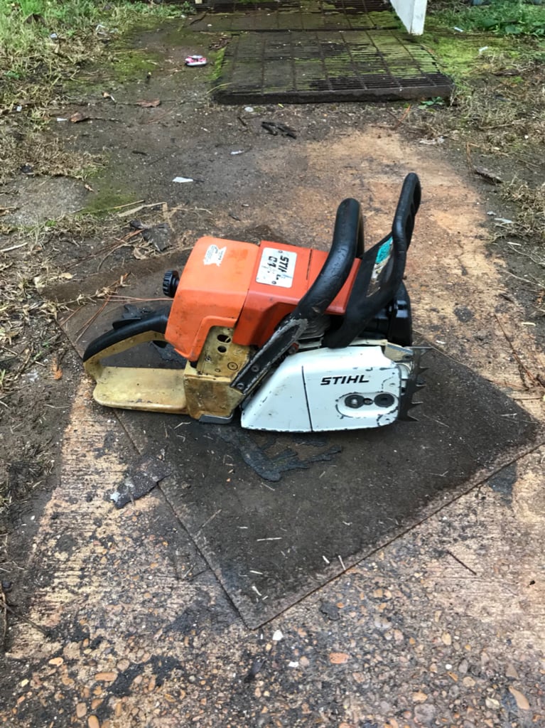

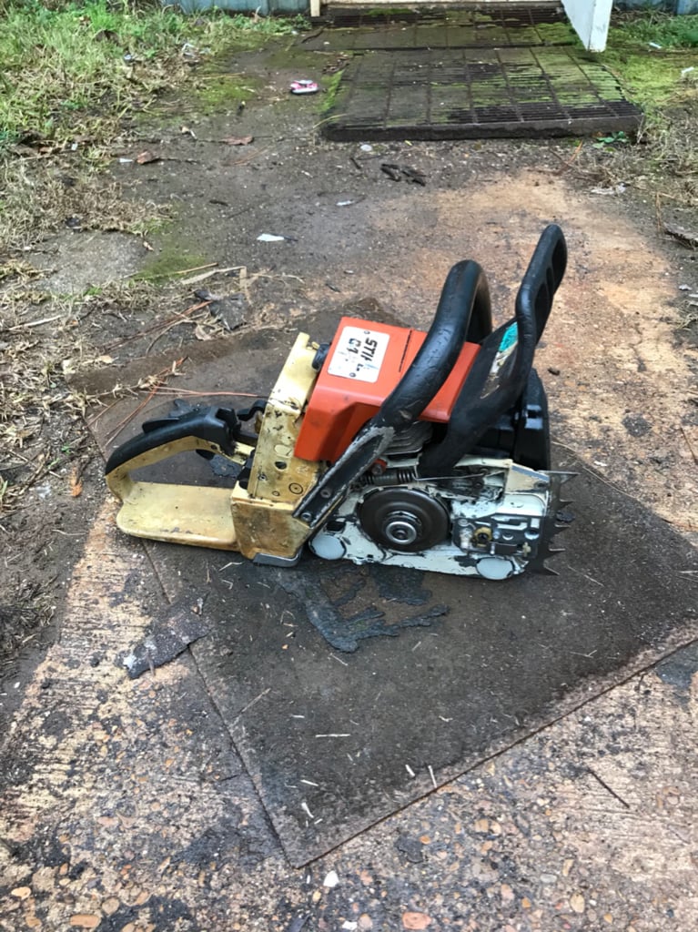

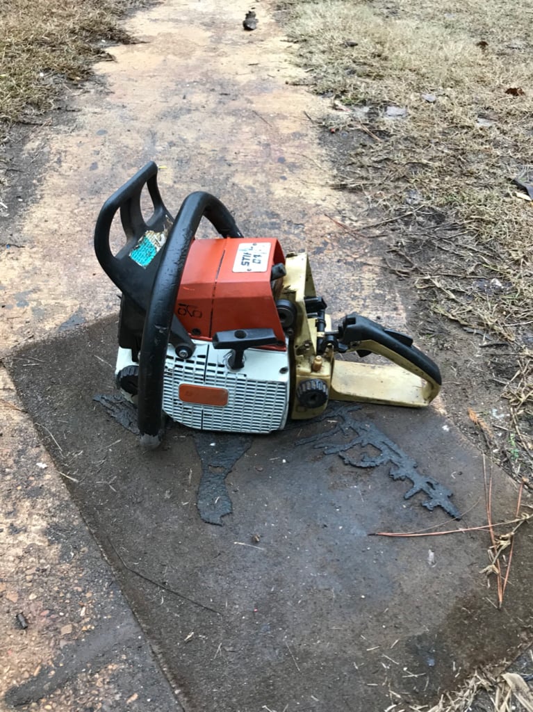

This 044 that is so far 100% oem. The air filter base and covers for the chain brake will be only aftermarket parts. I am waiting on those to come in. I will have almost $200 invested. Should I buy a new oem air filter cover? I plan on selling it after it’s done.

Put a maxflo on it.

Looking good!!
