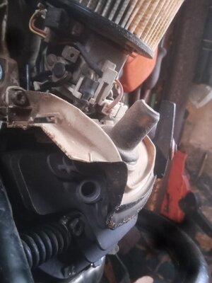

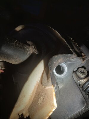

Blew the decomp valve out of my 462 today. Was sawing away in big Ash and she came flying out.
Upon inspection the piston and cylinder are fine, no scoring whatsoever to be seen through the exhaust port.
However, the hole in the cylinder that the valve threads into is wrung. I won't be able to get another valve in there securely.
What are my options? New cylinder or can I re thread the hole and get a valve/plug to fit?

I think you could find a heli-coil kit that would fix that right up. The toughest part of it might be drilling a hole that size straight through. On the other hand , being wallowed out the way it is, it might be opened up enough to not require drilling before running the heli-coil tap thru it. It certainly looks to me to be fixable without any welding.

Definitely a tap and re-thread. The quality rethread inserts are a little spendy. If you don’t use the de-comp you could just thread to a standard size and plug it with a short bolt and crimp washer.

Yeah people on FB told me to plug it with a bolt. That's what I'm going to do.
