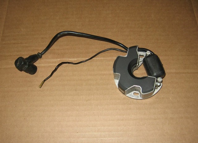

Somewhere on here I seem to recall seeing a SEM coil fix where someone cut the potting in half and spliced a chip in to some now-exposed wires but I can't find it anymore. Was I imagining things or can one of you guys point me to that post?
It is Bosch ignition that you can fix with a capacitor not sem. Not sure if there is a fix for sem. What is the ignition on? What's it look like?
The victim is an 056 Johnny Cash saw. It's the earlier two-piece looking one like the guy below. It wasn't a capacitor, I'd swear a guy cut the top off of that chunk of potting and ran two wires out to a nova chip, but I could be imagining that.

I have done that on a Bosch could you swap it to Bosch ignition do you have a flywheel? I just did my first fix with a capacitor thanks to @av8or3 this is what that looks like. If not I may have one of those older sem units on a dolmar I can check tomorrow.
I've got a good Bosch coil, all I'd need to do is cough up $45 for a inner flywheel bit. I'm fine with coughing up the $, I just seemed to recall a freebie way to fix it so I wanted to explore that route first.
Maybe someone else will know how to fix sem before you buy a flywheel.
Anyone know if the inner flywheel is the same as the dolmar ones if so I probably have one

I have no idea, the only Dolmars I’ve handled were a pair of 133’s and I never did anything more than a carb rebuild on them.
Got a good picture of the flywheel you would need? Dolmar used at least 2 different ones with the key in different spots. I have at least one of these 2 see key location compared to bolt holes and starter pawls
Can do! The Bosch # is 0 204 098 008
