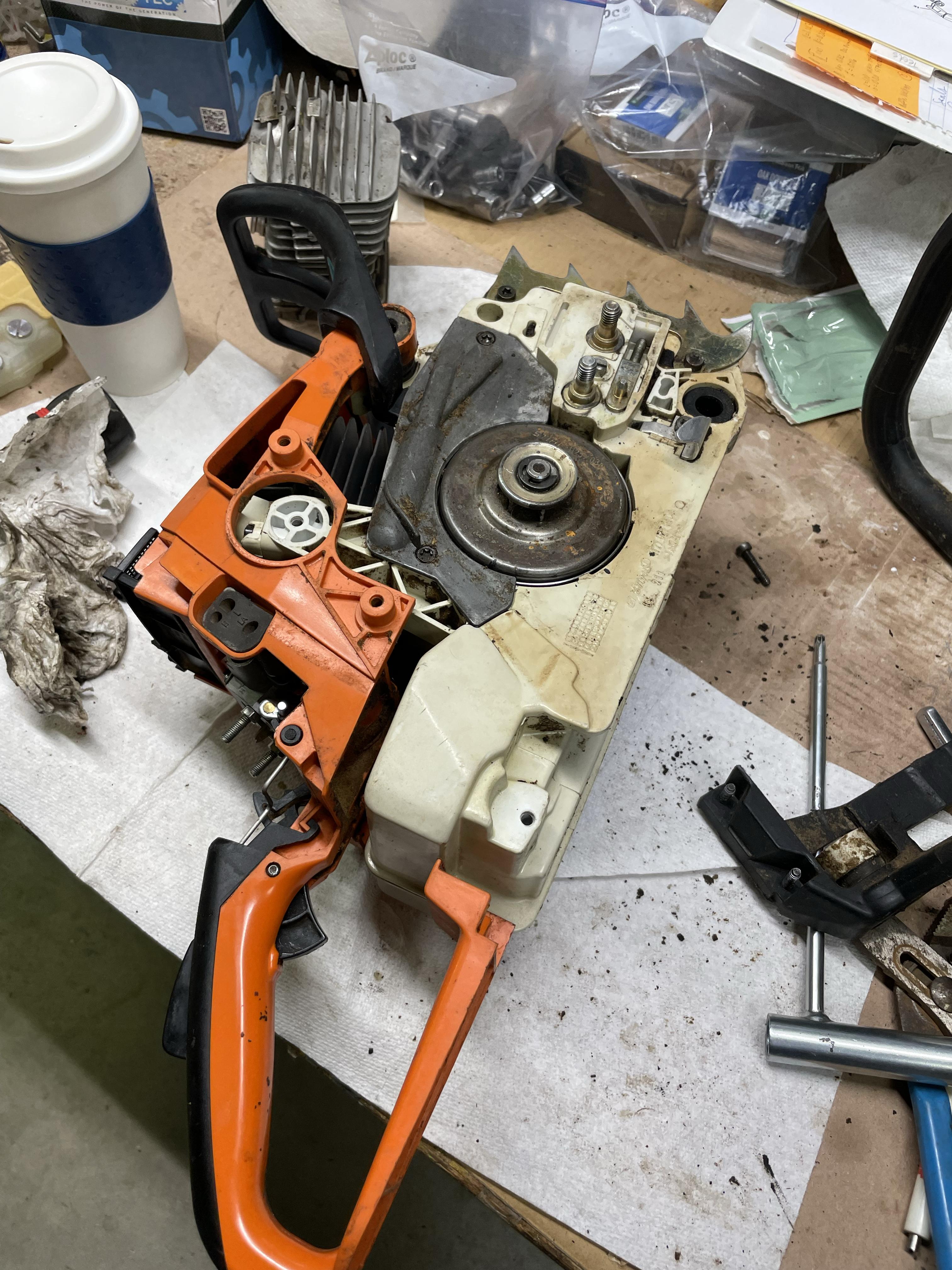

Whats all broken that you can see so far , case useless?
Flywheel side case, brake flag, top handle, fuel tank, clutch cover, all av springs, muffler (or just bump it out). Case sides are not available separately, you buy both for around $450, short block around $580.
Good lord!
I mean I understand why you would buy a new saw if it was skidder modified now.

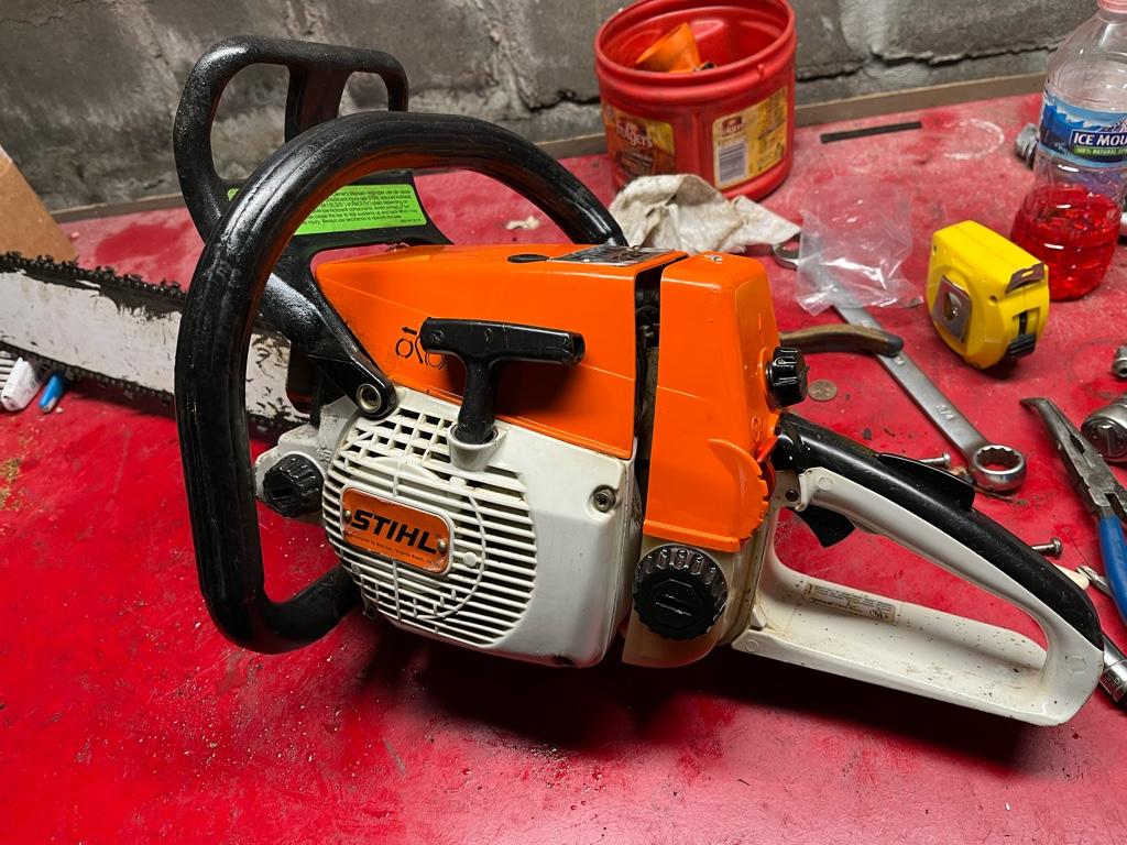

Cleaned up this 026 I got couple weeks ago, had wrap handle and few other things it needed. Ordered a carb and it runs great.
I've got a buddy with an 026 as well, I've had the pleasure of running it a few times. Just limbing with it. Pulls the 18" that he has on it with noooo problem. Enjoy it!
