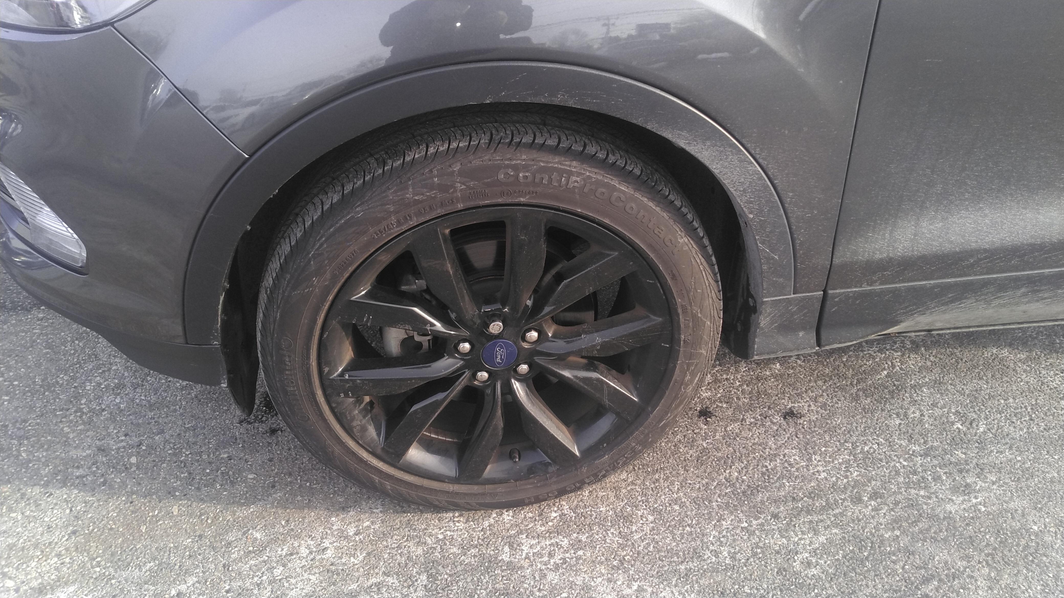

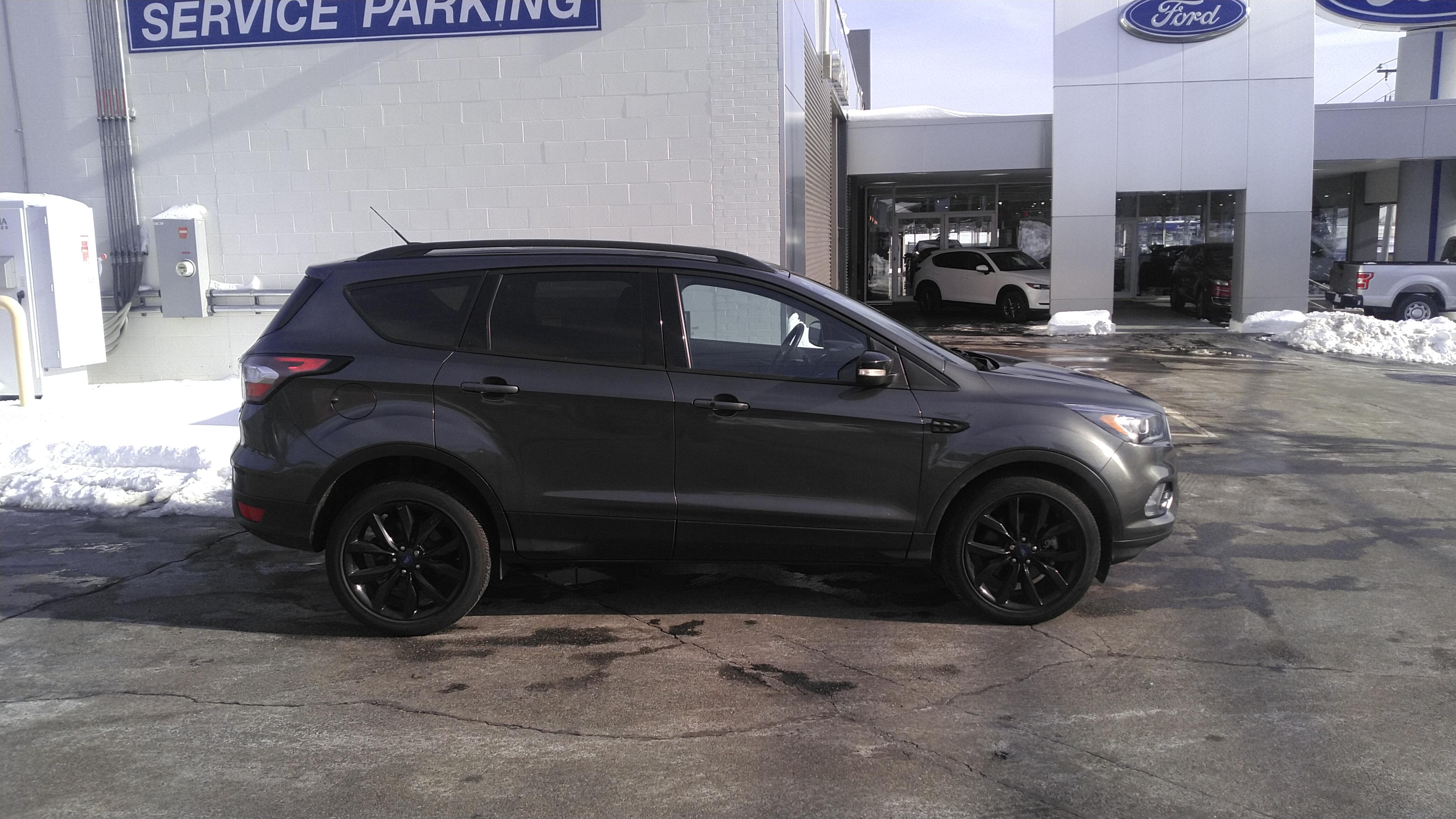

Bought a new ride today. 2017 Escape Titanium 2.0 Ecoboost 4WD.

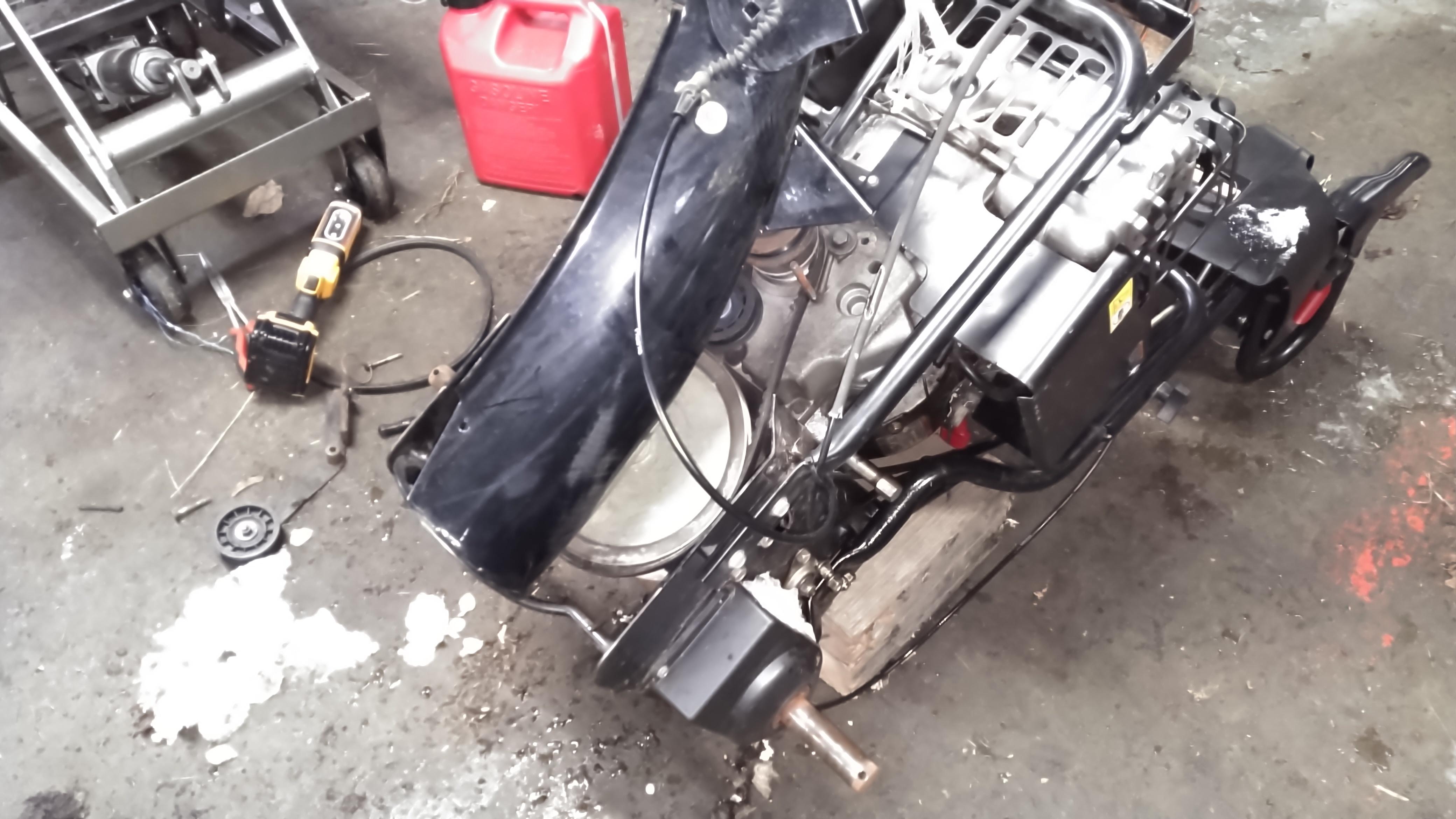

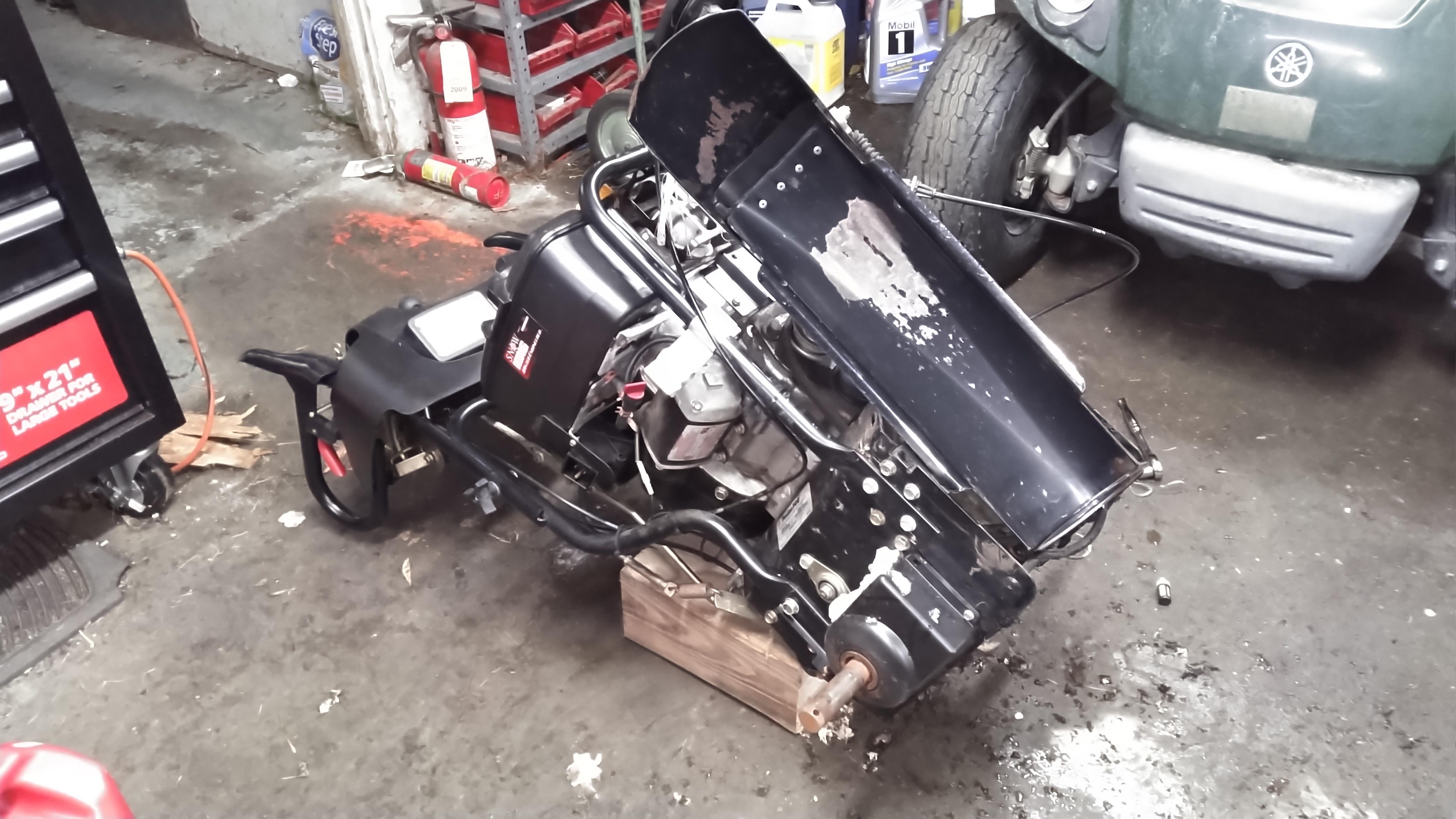

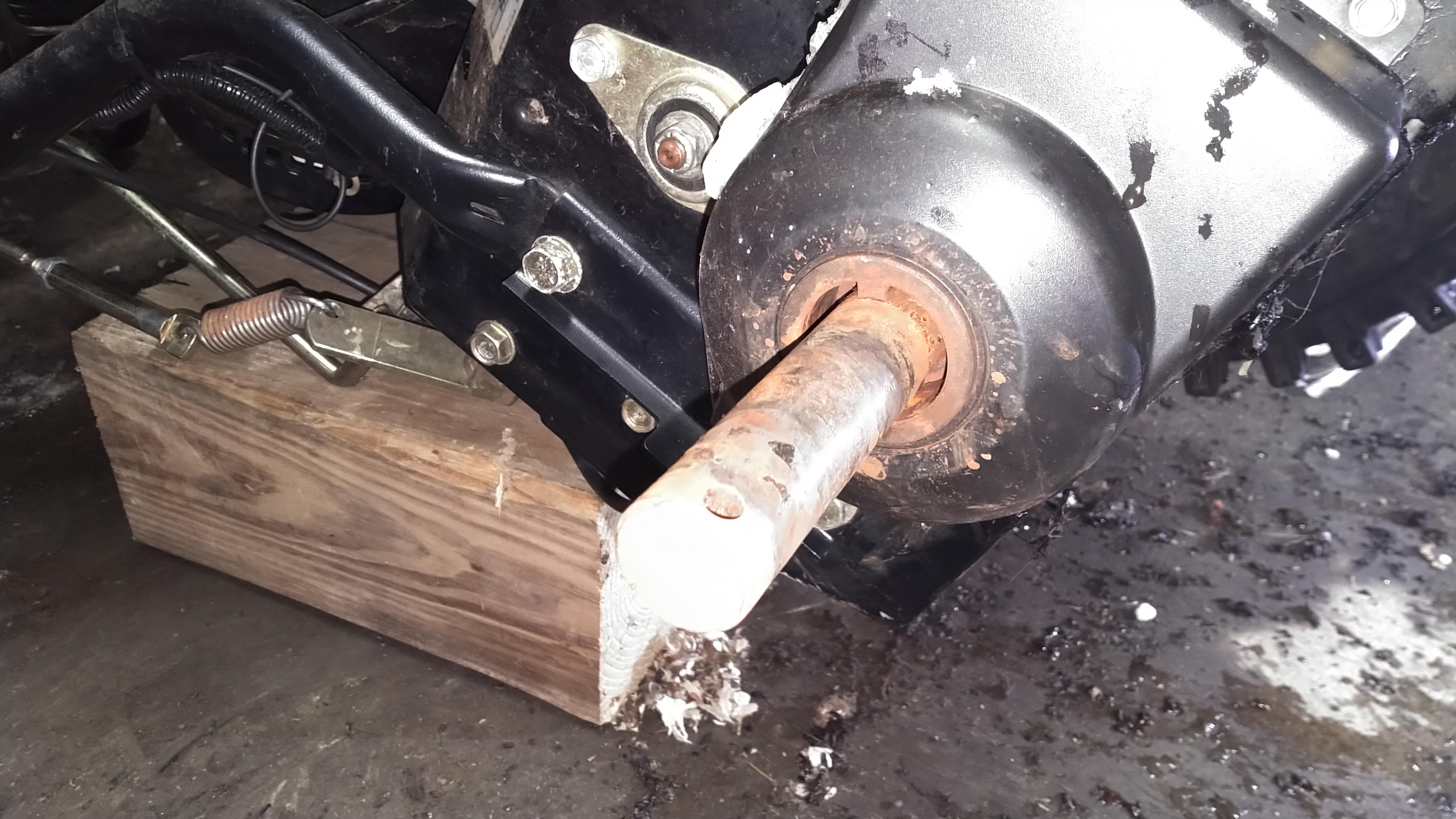

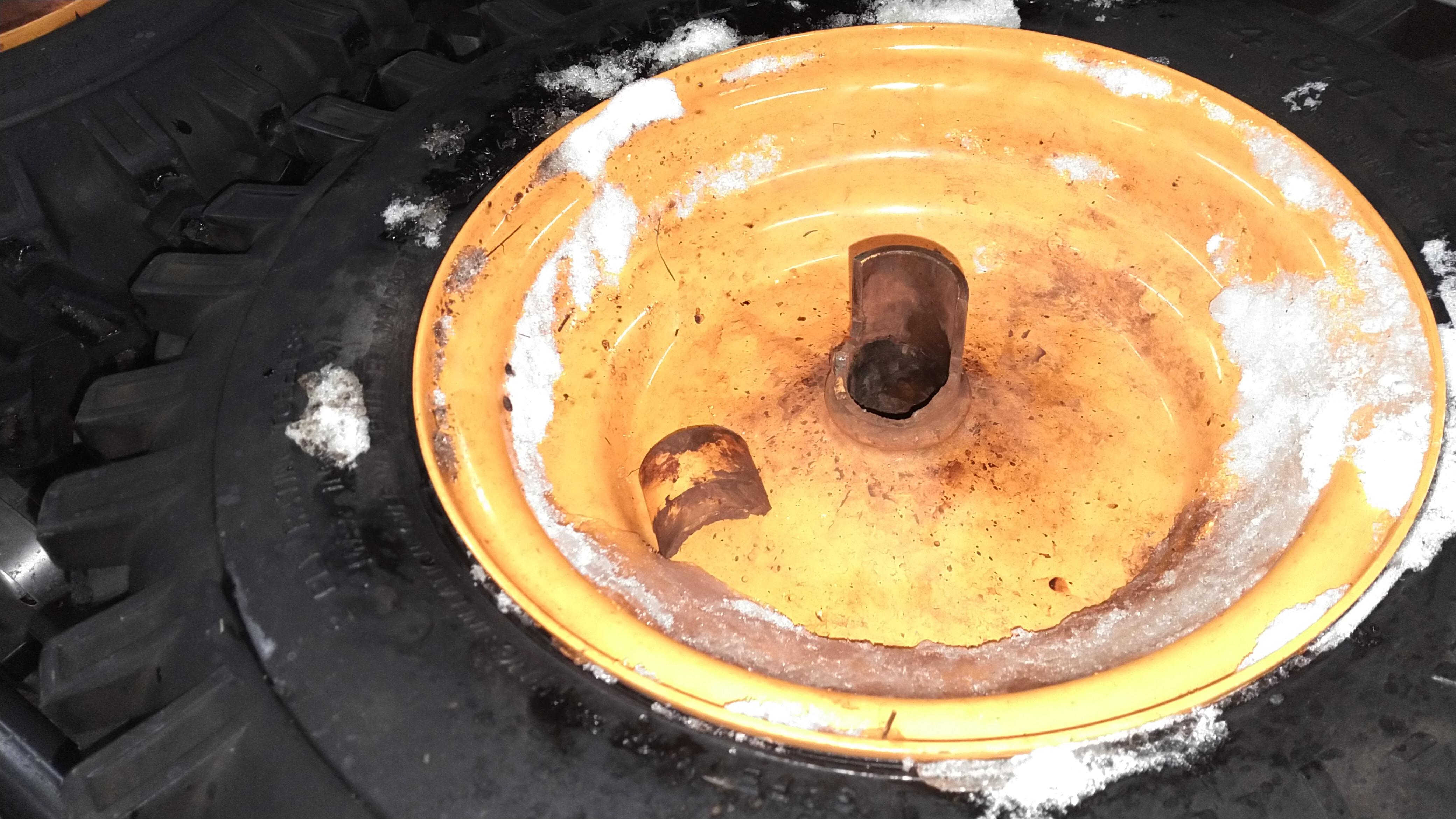

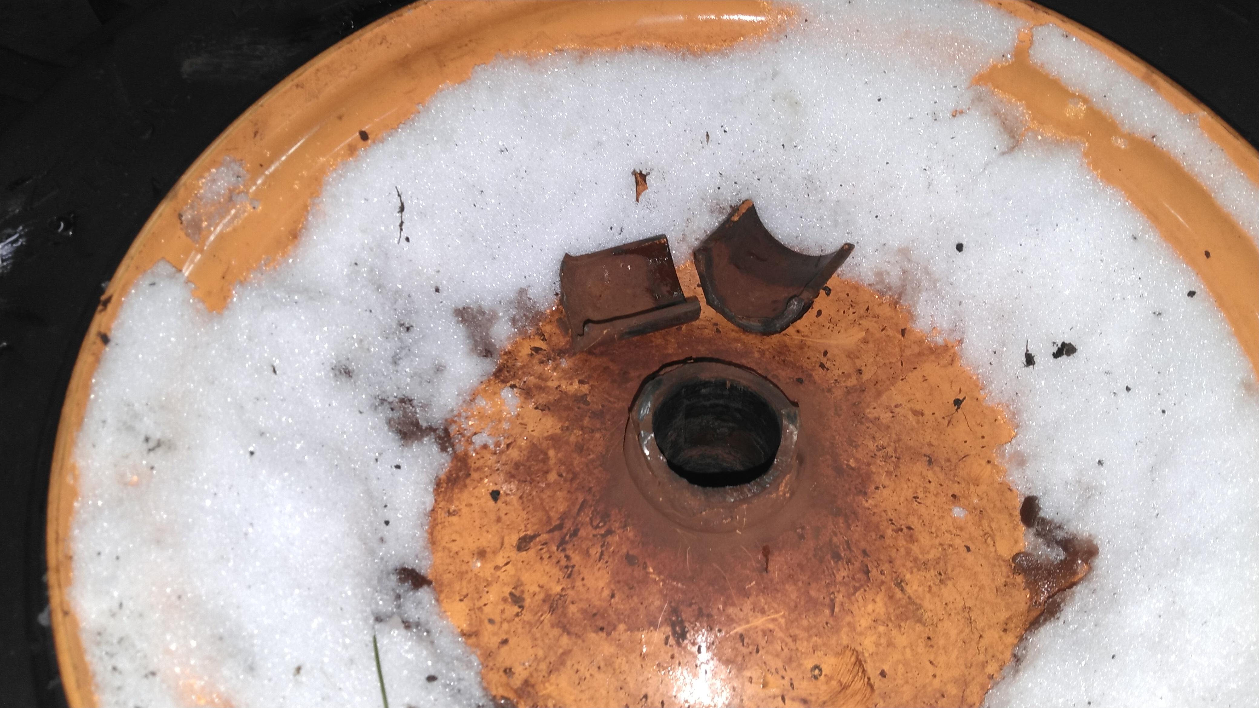

Last night I picked up this poulan pro snowblower for repair. Complaint was the left side wasn't driving and the auger/impeller wasn't working. Removed the belt cover and found the auger/impeller belt worn and off the pulley. It'll be getting a new belt. As for it not driving on the left side, I pulled the wheel off and found the drive collar busted off the rim. Decided to pull the other wheel and found the drive collar half broken. Very cheesy design. New wheels are $130 each, I'm going to see if my boss can weld them up to save the customers money. Also found the belly pan packed with a mouse nest and found Mickey frozen in his nest which I thoroughly cleaned out.
