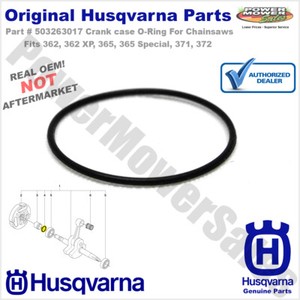

I’ve got this 372 because it had erratic tuning. Would idle at 3000 the surge up to 4,000 and quit. Ran good in wood but fight the tune on the tach. So I was suspecting an air leak. Not very familiar with the Huskies. I am not seeing any leaking around the actual seal but I’m getting it through the Collar on the pto side. Before I took the saw apart it would hold around 7 psi and then slowly leak. When assembled is there something sealing the top of this collar? Or is it a confirmed seal?

You need the oring for that side

OK when I took it apart I didnt see any o ring so obviously someone’s been in here before does the worm gear and the clutch hold it down? Thank you btw.
I see now it’s under the collar.

Yes the clutch tightens against it

OK so I just took the collar out and I don’t see any remnants of any o ring. I’ll order one now
The o ring usually disappears. I've only ever found a couple. Replace it and pack the sleeve with grease. Also make sure the face of the clutch that seats against the sleeve is flat so it can aid in sealing. Just a few things I've picked up that seem to help with the somewhat flawed design. I will normally go with a new sleeve also.
