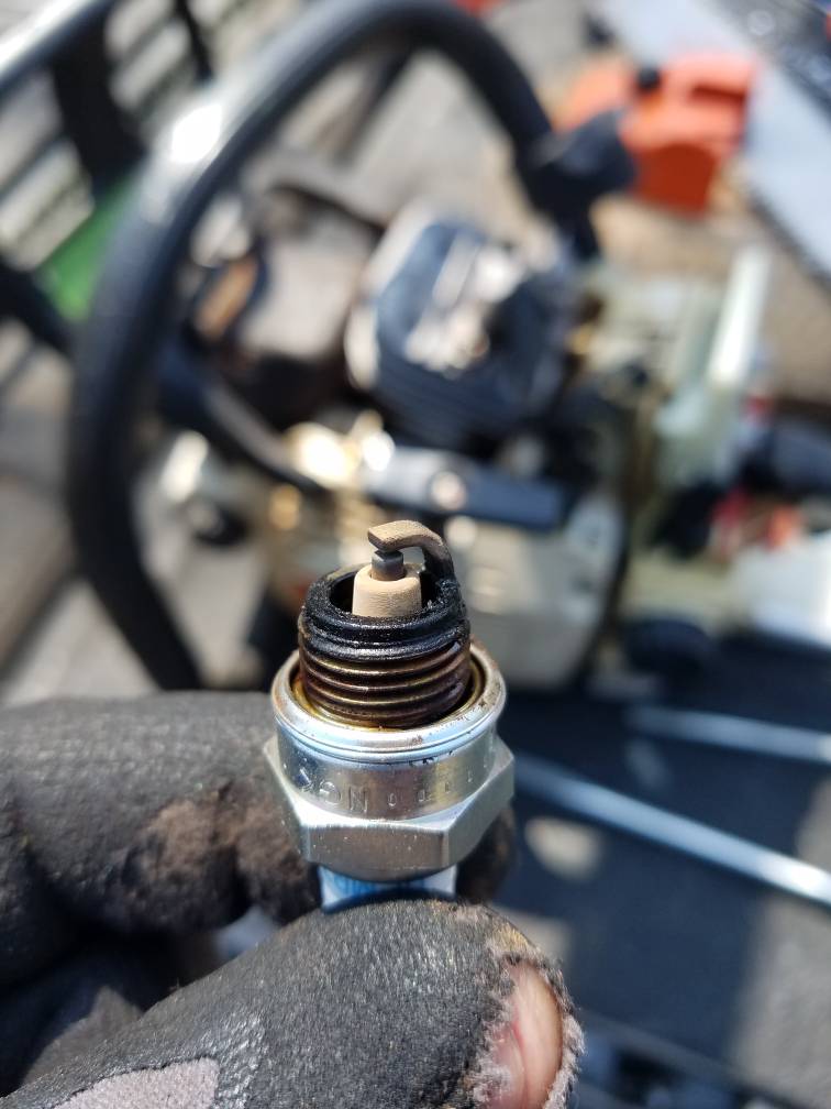

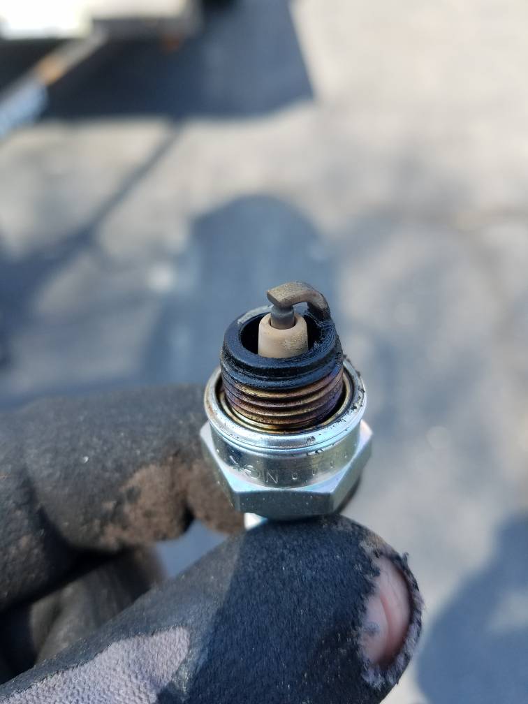

This is my plug after running a Red Armor, Klotz, VP oil cocktail. Oil used with VP SEF.
MOFO 026 with a generally fat tune. Just cut 4 straight days running saw WOT for most cuts. Went through 1 gallon of bar oil for the job. 8 decent sized trees, 18 to 20" diameter sticks. Plug is the same one that came on my saw. About 2 years old.
Around 32ish:1.

This is exactly why I have stayed away from Klotz original techniplate, and a few other oils like Dominator, Red Line and a few others. These oils state specifically they contain no corrosion inhibitors, and are notbro be use as storage lubricants.
To me most of the high end oils run clean. IMHO other factors like fuel, tuning and how the saw is ran, determines internal cleanliness, not just the oil. Only a few oils made a true mess of things, Klotz super techniplate comes to mind.
This is also why I prefer a synthetic blend oil without esters for saw use.

Yes
This is one of two reasons why I asked:
I only notice “condensation” in saws with OTP and the Klotz OTP container says for race only. Doesn’t say anything about corrosion protection and even suggests fogging if you’re going to be storing it.
Just about every other good oil says stuff about corrosion protection and some even have fuel stabilizers for storage. Maxima K2, for example has details about corrosion protection.
Also, I’ve got some old Red Armor, smells like dead fish ........ the new Red Armor doesn’t smell like it at all. It’s definitely alot different from what it was
The old Red Armor did have a bit different formulation as compared to run of the mill OPE oils. As its formulated now I cant justify the price.
I still personally want an ester based oil. I believe with the right additive package some of the issues with ester are negated. K2 and others have good corrosion resistance from what I've seen. The positives with a properly formulated ester based oil outweigh the negatives IMHO That said if corrosion is ones main concern oils like 2R and HP2 are probably the way to go. Thus far I have seen no reason to switch from K2.
K2 is an ester blend and I really like it. However, I wouldnt trust any ester or ester blend oil for storage long than a few weeks in a humid climate.
Agreed. However I've had saws ran with K2 and R50 sit for 6+ months and have yet to see any signs of corrosion.
I did that sort of stuff for years and had no issues until one day I did. Lesson learned. Although, now that I live in MT where its bone dry its less of an issue.

I did that sort of stuff for years and had no issues until one day I did. Lesson learned. Although, now that I live in MT where its bone dry its kess of an issue.
I would venture to guess the oil was only one part of the problem, as you said environment plays a key role.
