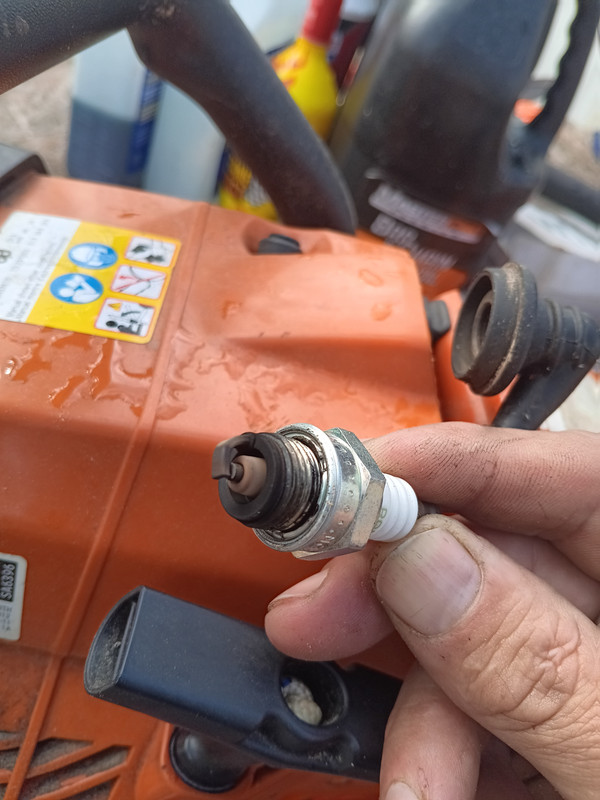

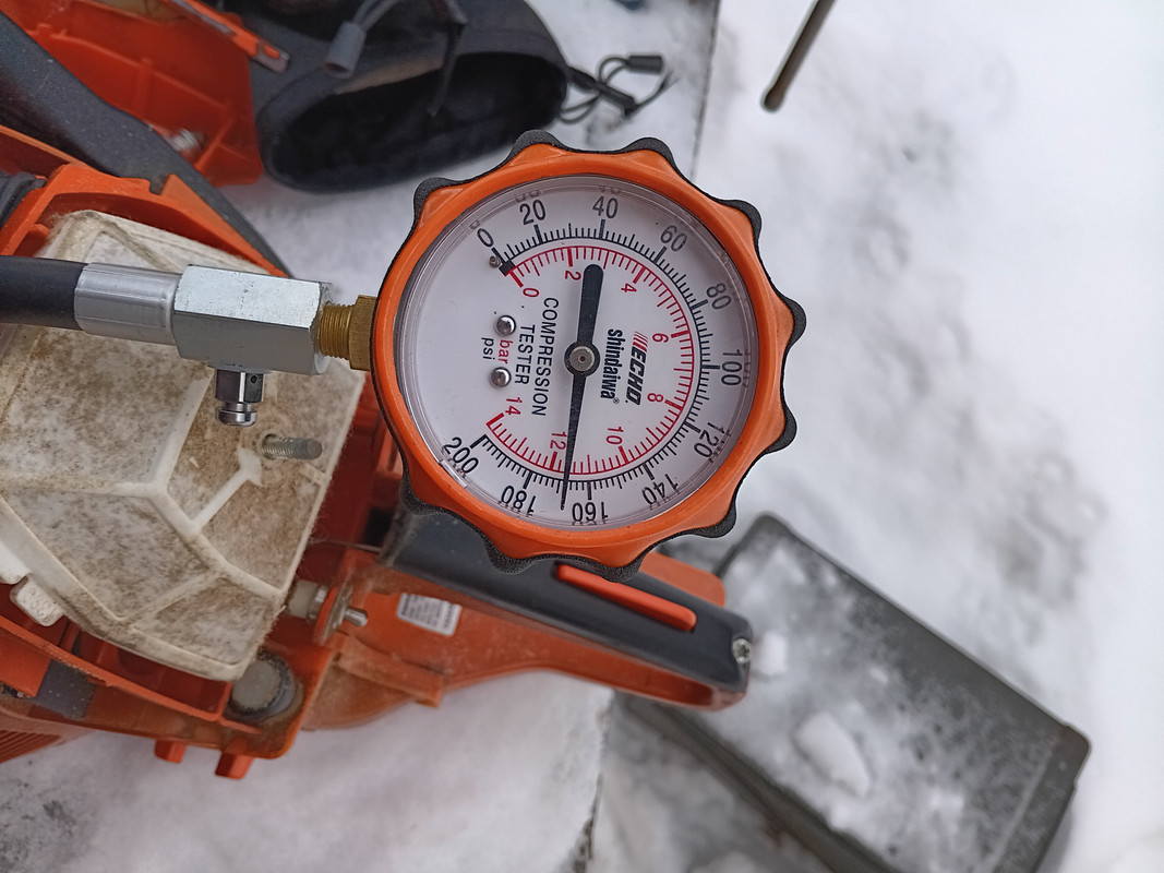

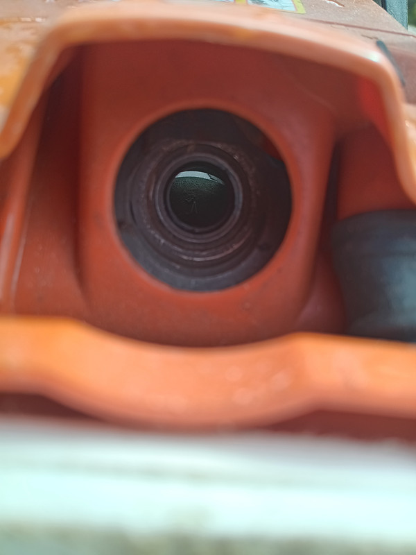

As promised, I'd report back after one year of personal and commercial use on a cs 590 saw that has been run on nothing but Lucas oil at 32:1 since the saw was new.
The mix fuel has always been 90 octane, a smidgen of mmt, and a smidgen of either strartron or marine stabil.
I'd estimate about 800-900 hrs total time on the saw. Nothing too crazy: walbro 86-587-1 fuel nozzle, base gasket delete, timing advanced, muffler opened up, tuned to 13,200 rpm.
170 lbs of compression at the 1yr mark. No scoring on piston. The thin layer of carbon at the sides of the exauhst port can be scraped away with yer finger nail. The carbon has the consistency of grainy bubblegum.
There is a slight bit of staining near the piston ring.
I will continue to use this oil in my fleet of saws, brush cutters, augers and snowmobiles as it's only $ 9.99 a quart.

I didn't. But then I've put 2,800 miles on an Enticer 2, using Lucas as an injector-oil hauling nothing but 16 ft slabs, firewood and a home made trail groomer. The entire rig is falling apart around the engine. But the engine runs like a top.
Then 5 gallons of Lucas 32:1 mix fuel every 3-4 weeks through all my saws, never an oil problem yet. If there's was an oil issue, the constant milling of 16 ft slabs would've shown something.
