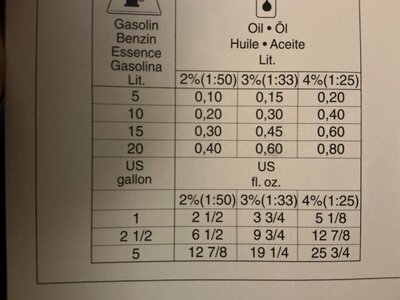

This is from an operator’s manual for Husqvarna 61/268/272XP saws dated 3/1996.View attachment 476718
I've heard of the older manuals mentioning a 32:1 ratio for saws above 70cc outside of the U.S, does that manual by chance mention that? I am yet to see one, but hear it mentioned quite often.

Thanks for posting that, I have been searching to find a picture of that, one of the employees at a local shop is hell bent on lecturing me on how bad it is for me to be running 32:1 in my saws. I am going to show him that pic.
some people are soo smart its a waste of time trying to talk to them, hes one of them.

If the saw will tune for it and it’s not building carbon, there are no drawbacks.
In fact if he knew much about strato technology, he’d know that they need about 35:1 just to make up for the lack of oil/mix going through the saw due to their efficiency.
Basically, if a saw is 25– 30% more efficient, that’s 25–30% less fuel and oil going into the engine to lubricate the bearings
