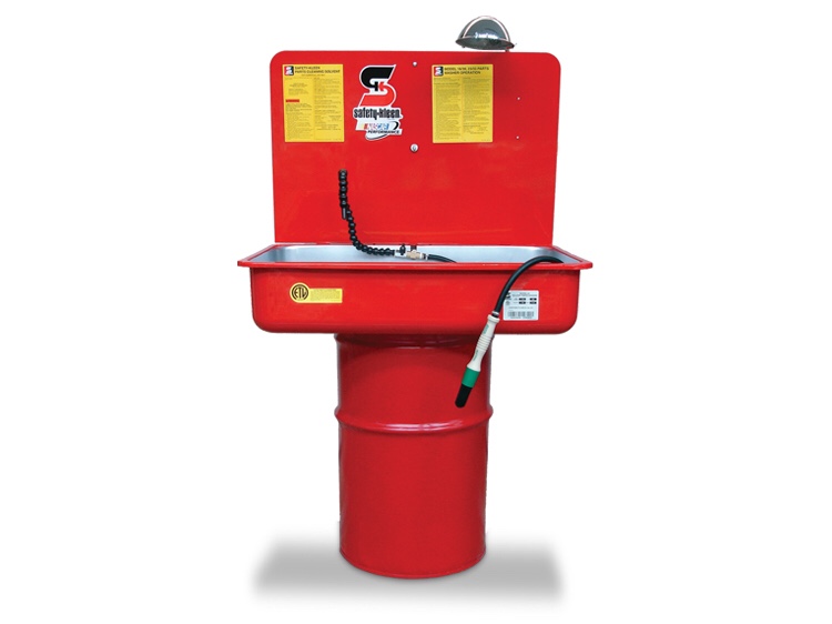

My USC isn't big enough for case halves. I finally got a 20-25gal automotive parts washer with circulating pump that goes through a stiff brush. I seriously don't miss the days of purple power and simple green in a 5gal bucket! I put a cookie rack in the bottom of my parts washer and leave the case halves in their to dry. I use the mineral spirits base cleaner b/c my shop isn't heated all year round. You can find these cheap on CL if you look for a while. Mine was $40!
Mine is a crusty beat up version like this...
If you worry about changing fluid... Don't! I use its own pump to run the top 85% of the liquid into 5gal buckets (straining it as you go). Take the last 3-4gals and mix it up with all the chunkies in the bottom strain as you pour into the last 5gal bucket. The last bucket can be reused or you can turn it into your local household hazardous waste facility for free. Usually they will pour it into a "fuels" bulk container. Anyway just top off with another 2-4 gallons and you'll be good for another 2-5 years. Repeat as necessary...
