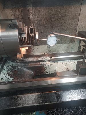

My Buddy bet me I couldn't get the saw running from a broke down state in 1hr...
I missed it by 3 or 4 minutes... I had to run out to the garage, dial the piston in and cut it.

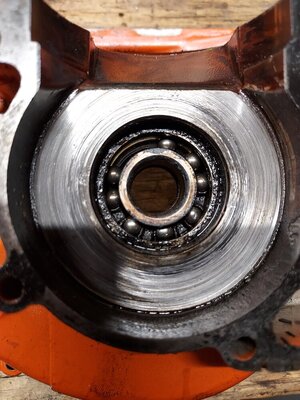

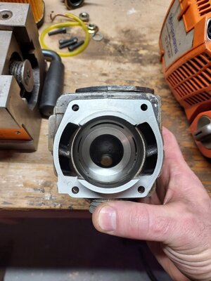

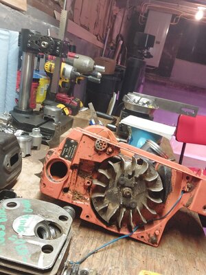

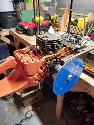

I thought I had a video of it blowing up...
Maybe it's on the laptop.
Here is the aftermath...

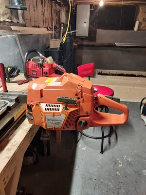

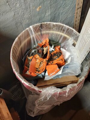

A few random

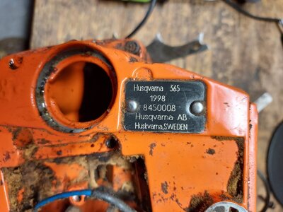

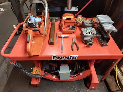

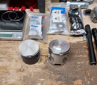

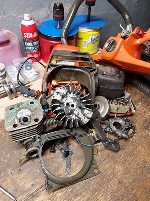

During the build/rebuild process.

I machined an adjustable v-block so that i could check my cranks for run-out... the 372xp crank ended up having .025" of run-out... we dialed it in to what I would assume is oem specs... just guessing on that. Most stihl cranks I have checked are .0002" or less.
