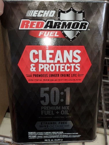

Cleans and protects! Says it on the can! 93 Octane for mo powah!
At Home Depot
Lowe's has 40:1 premix, so I hear...
