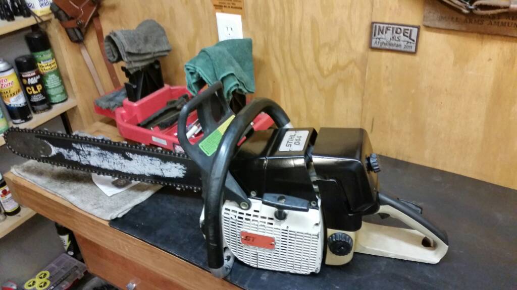

I just finished up a beater 10mm saw. With the help of some good fellows on here I was able accomplish just what your your doing there. You will be very happy. Here's a pic with the rattle can finish. Have fun buddy.
Haha sometimes I stutter and fogot words when I'm excited [emoji13]
Dude couldn't you find a more orange color????
