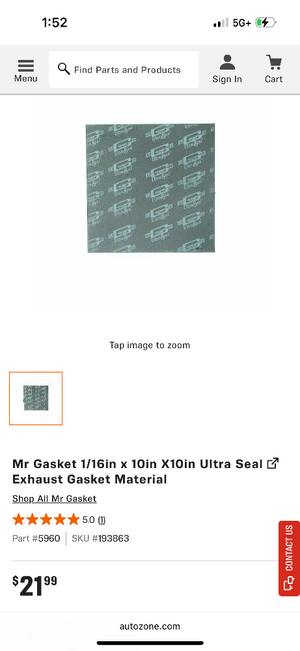

Local vintage motorcycle restorer swears by this stuff. Says it's the only thing he's found to keep tailpipes sealed to the cylinder on certain makes. Haven't used it yet but will soon.

For exhaust gaskets I bought Mr gasket brand header gasket material. Came in 12” or so square sheets, looks like black felt and has a metal core. Otherwise just rolls of black or cork gasket material for the rest depending what’s needed.

I like the look of that. I'm doing some pioneers and the reed blocks are really taking some attention to get sealed reliably. The oem intake gaskets seem to be made from a material that is thicker and softer, more conforming than the felpro stuff. I have been trying out a layer of 1184 to help but it seems like the recipe was changed and, although it is less annoyingly stringy now, I am not sure it is as effective. I'm going to see how the Dirko performs.
