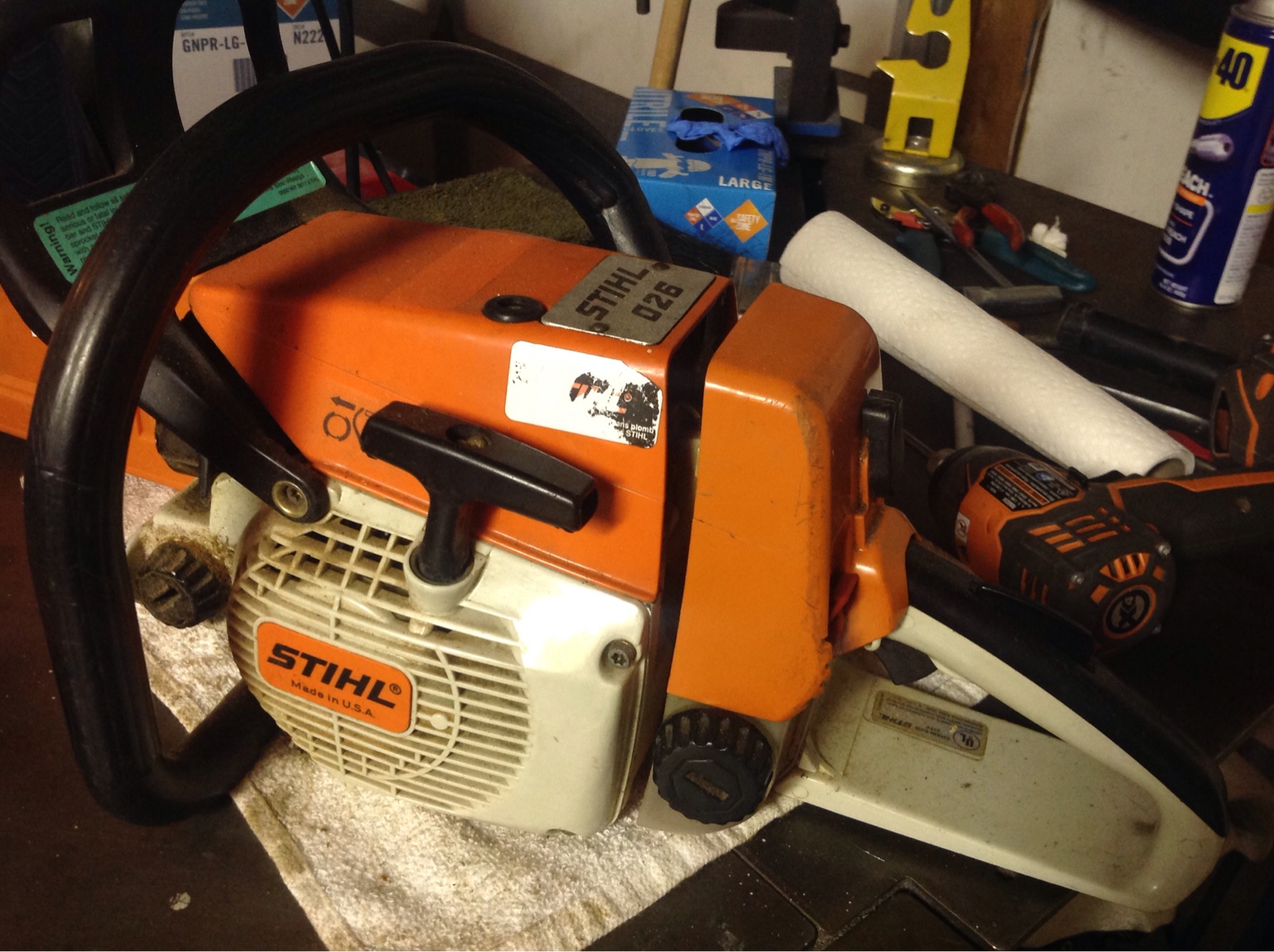

You need a 260 AF cover for the back end and a modified tank vent on some models.
Plug comp hole with an ear plug.
What is the usual tank vent used to enable the use of the 260 filter? The crappy thing is I just bought the tall black vents that were missing on two of these tanks...

You have to cut the tall vent at an angle and melt it closed. I'll try to get u a pic.
Do you have to put the screw back in the top of the tall vent?
I would definitely like to see that mod
The 260 vents do not work way to big.
I ordered an 034 tank vent from my dealer I can look up the part number when I get back
I know it is a 1121 #

I didn't do this work.
Mark71gtx
11:40 AM
539
Jan 14, 2016
1,207
2,097
Fuquay Varina, NC
It is hard to tell from the pic, but does it have the screw on the backside still? Does it leak fuel at all?

It does not leak fuel.
It's @Basher work. I own one of his ported 026's. Runs great. We have different styles of attacking this saw.
I haven't personally tried it yet. I like the look of the 026 rear (she's got a great ass) and the 026 metal filter flows more than the 260's unmodified. It's just pricey and tough to find.
Myself and @huskihl have modified the 260 filter for metal mesh. Comes out a bit fugly but it's not so hard to do.
I have done more than ten tank vents that way and they don`t leak, the top screw is just a means to allow air to pass across the top of the vent connecting the two passages in the vent. It works as one passage up on the front and one passage down to the tank on the back. The top screw can be eliminated and not cause any issues. The cone shaped vent covers will not fit every 026 tank, the ones that come with the tall black vent has a smaller diameter shoulder and the cap will not be a press on fit.

I have done more than ten tank vents that way and they don`t leak, the top screw is just a means to allow air to pass across the top of the vent connecting the two passages in the vent. It works as one passage up on the rear and one passage down to the tank on the front. The top screw can be eliminated and not cause any issues. The cone shaped vent covers will not fit every 026 tank, the ones that come with the tall black vent has a smaller diameter shoulder and the cap will not be a press on fit.
I like it, is there a method? Or just cut it and burn it? I see the angle in Al's pic
Guessing just to clear the 260 filter
So... What is the hack to fit 026 old AF covers on the 260 filters?
Great info appreciated Basher!
