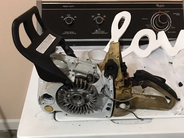

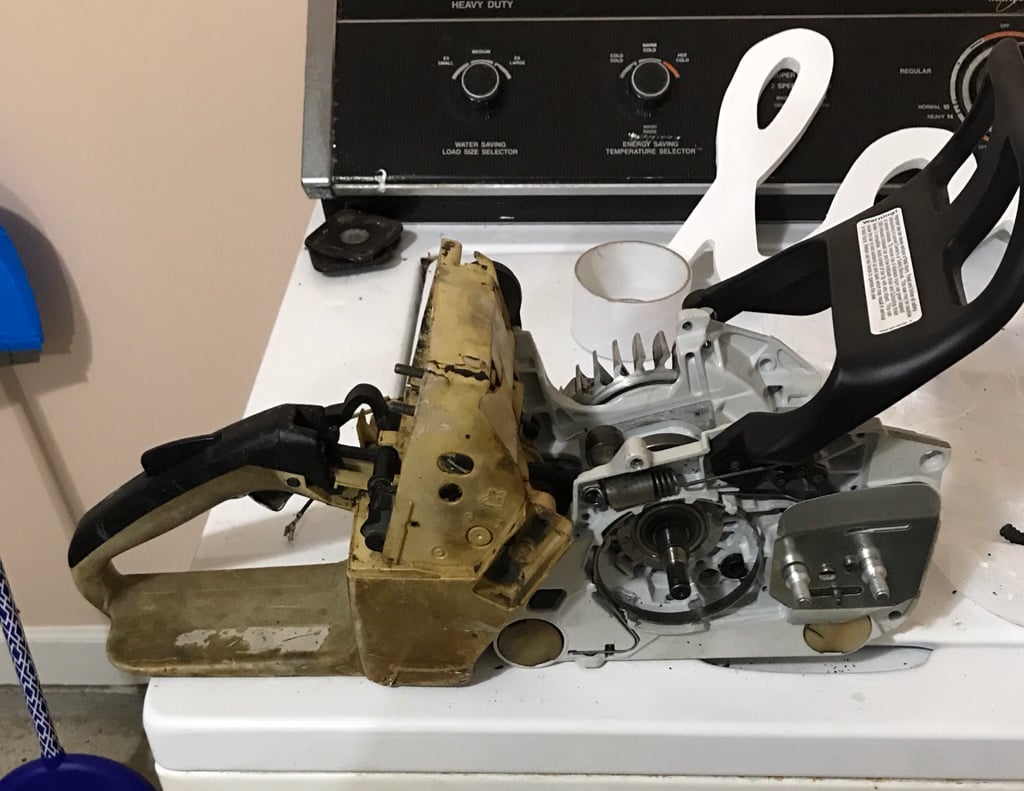

Thanks everyone. I heated the case, tapped out the old bearings. Heated the case a little more and the new bearings went in half way. I then used a bolt, nut and washers to pull them in the rest of the way.
