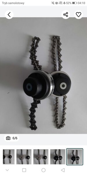

I got it together with the trimmer, but I don't dare use it 😉

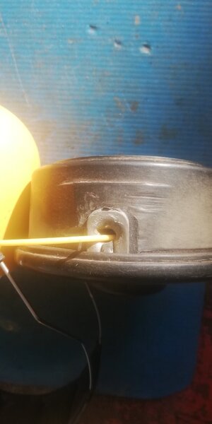

I am adding an additional spring to the Chinese clone T25

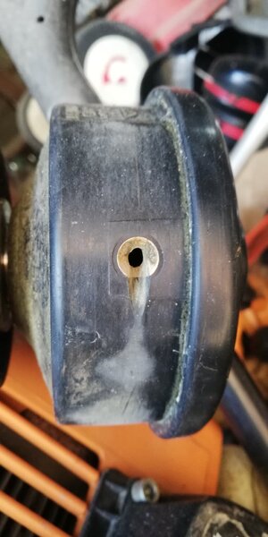

A bit of Dremel and I turned the guides to the other side because it was already very worn / Chinese maple 25-2 Stihl

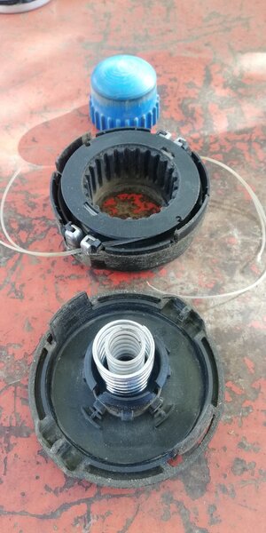

I found my first Alko heads, 10 mowing seasons, 0.5 ha, 2.4 mm line / I ordered 27-2 heads, but I have to change the nut - $15 with shipping

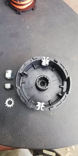

The Chinese 10x1.25 adapter fits, you have to insert it the other way around. The key is less than 19mm
The collar of the Chinese nut will increase the spring tension

In my opinion, the original nut in the spool 27-2 Stihl has too much play. If it weren't for the washer, it would rattle, I had to correct it, although probably no one looks there
