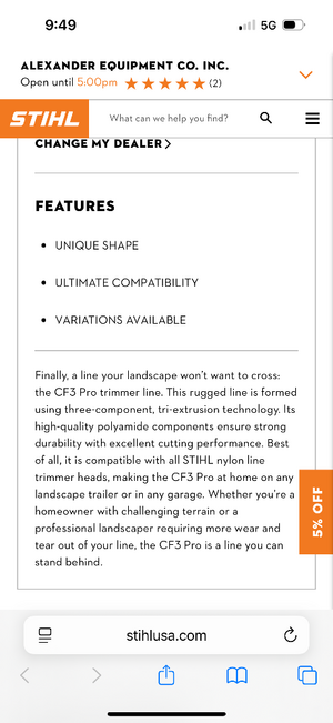

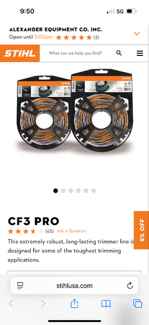

So far the Stihl cf3 pro line has been awsome, cuts well, holds up well and doesn’t seem to weld itself together or hang up in head. Stihl does recommend soaking the line in water 24-48 hours before use.

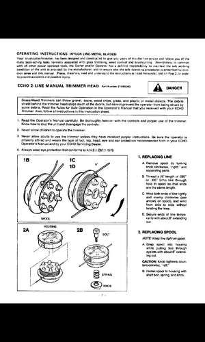

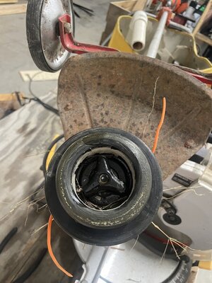

Echo srm 3800.
is that triangle thing supposed to spin off? I dont know how else to get it apart and put more line on it.
Its stuck tight

clock wise might help lol
Thank you. Got the trimmer from my neighbor. Needed a carb and fuel lines. Now it runs great. Even got a updated carb with a purge bulb.
