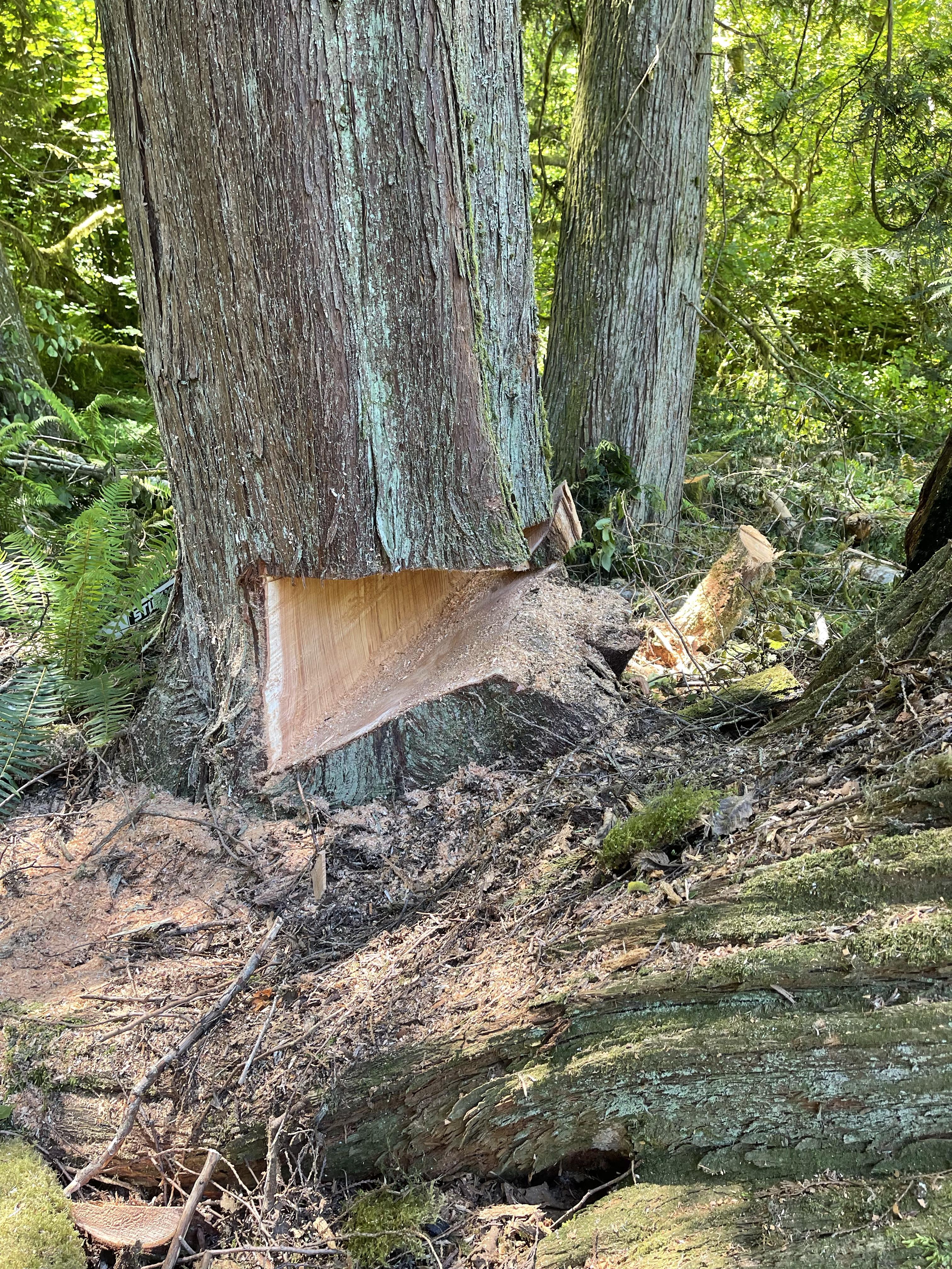

Wow. Interesting cut there. What type of tree is that you are cutting? Is it a softwood? Not quite sure how that would work in our hard wood that we have in the northeast.
That’s a western red cedar, if you can swing your hardwoods you can slip them too.

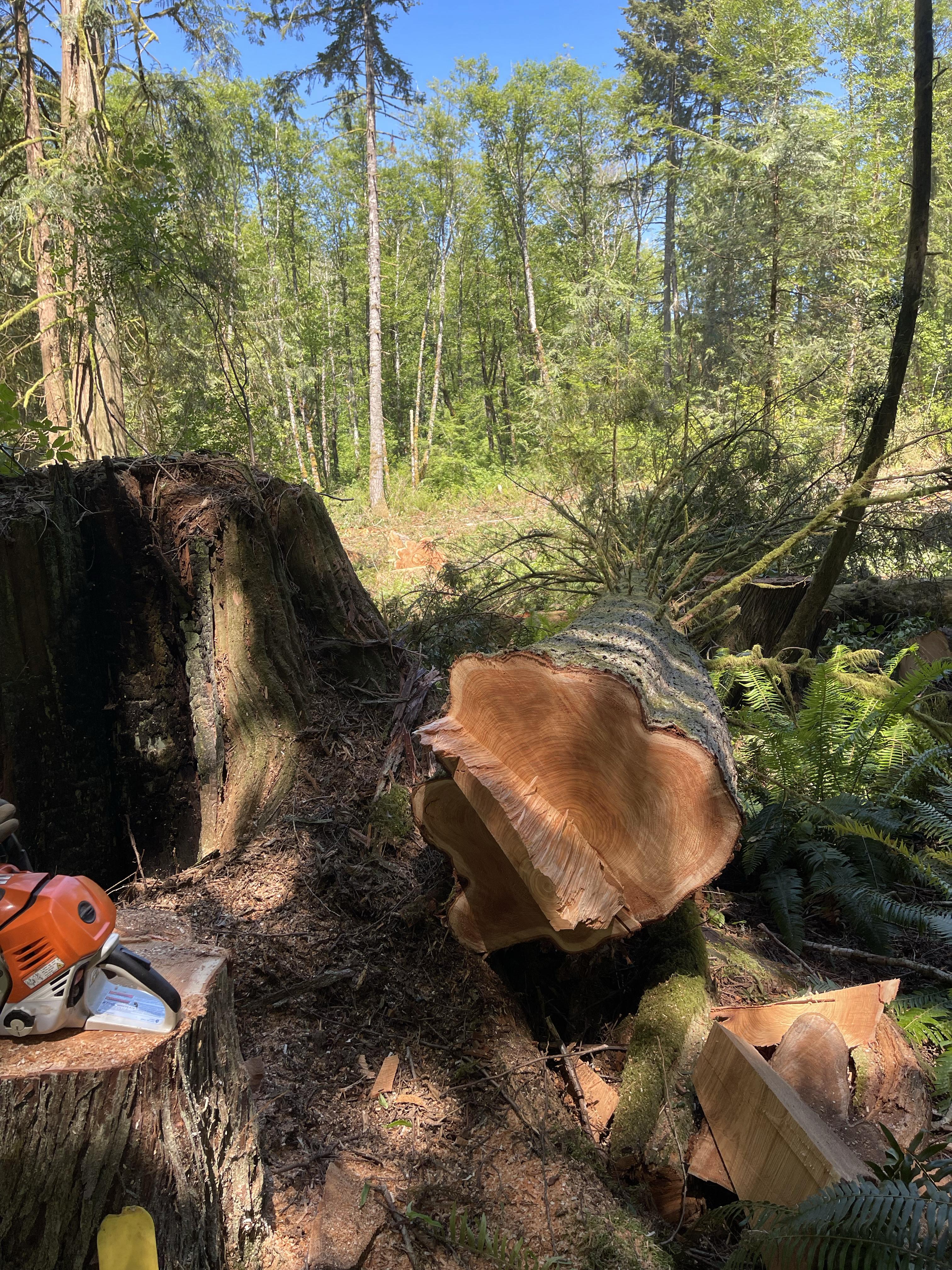

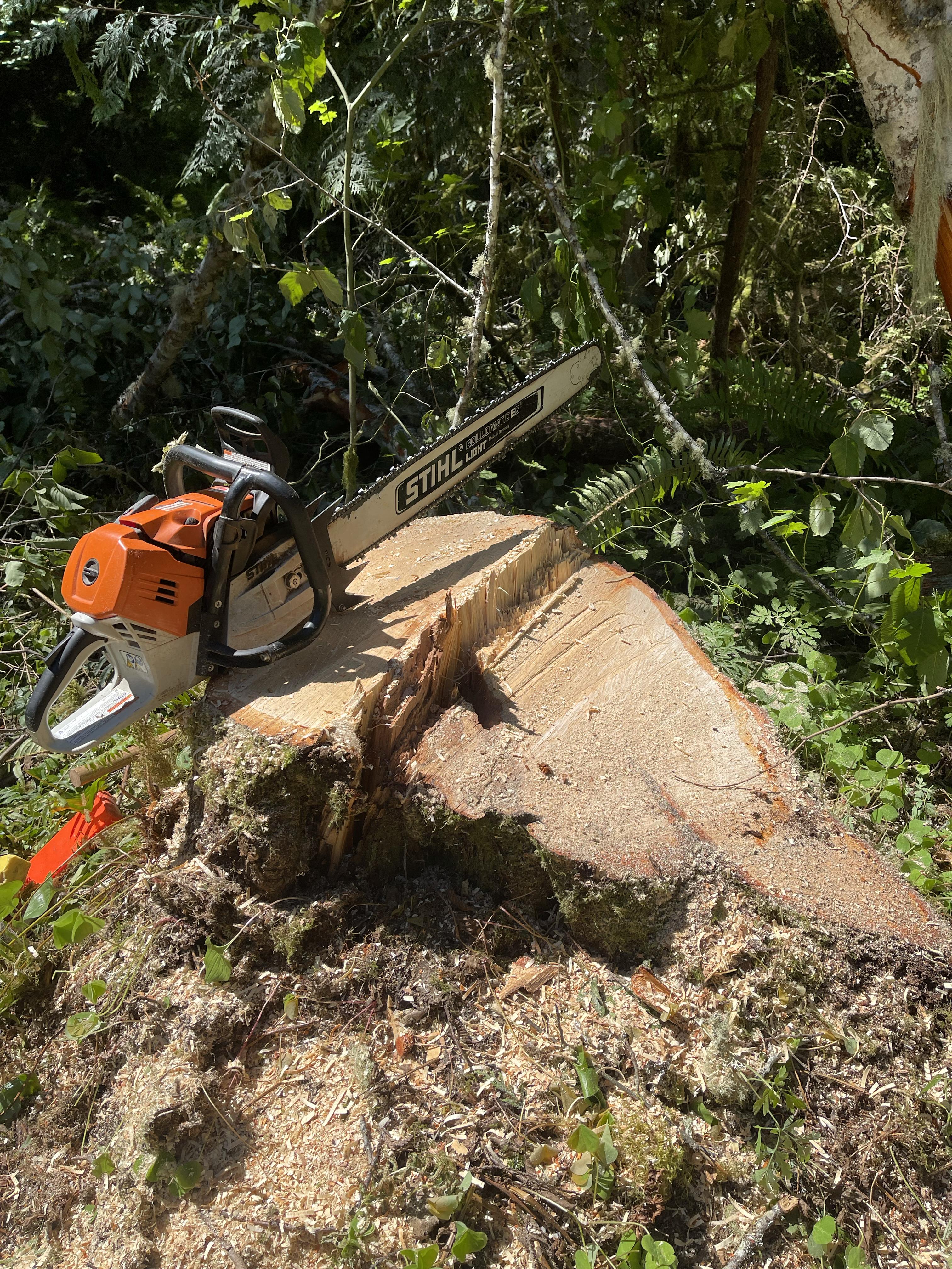

That face is a work of art. What are the mechanics behind it, please?
It started life as a block face with a humboldt bottom, added a siz wheel into the right side almost all the way across allowing the butt to slide over past the old growth stump well the top was heading out for the lay.
So it’s your humbolt with more cut out on one side (the side you want to swing away from the stump) and the face cut cut at the angle to allow for that movement? I’m guessing you used the wood wedge to pop it off the stump on that side first to further encourage it to swing around the stump too?
I didn’t swing it I slipped it off the stump to swing you’d need to turn the tree. The piece was place in there at a certain location to allow me to make dang sure I had enough cut off the far(right) side to get it to slip. When you place something in the face it can be used one or two way depending on location is A. Two start a swing or help and B. As a way to stall the cut this was used to help stall the cut.
Cool interesting stuff, I don’t cut trees like that here so it’s cool to learn about other techniques used in other areas. You never know when you might need to utilize an aspect of another technique to get the job done.
