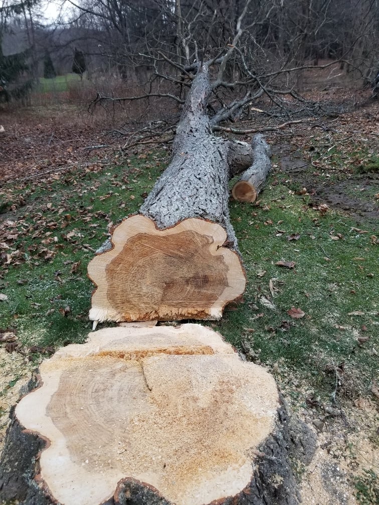

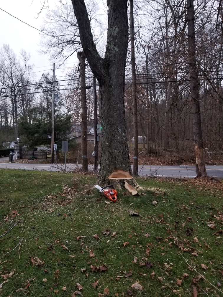

Smallish red oak from today. When I use a conventional this is how I usually do it. Small face, the little bit of relief cut in the face sorta acts like a block face in that it allows flex and clean breakage of fibers. Just face it and back it up. Works on hard leaning push or pull trees as well. Allows a guy to leave a thicker hinge without ripping fibers out of the butt log. Mason, try it out man

You finally used a real timber cutting saw.... Did it allow you to be more efficient? Lol

There is no 1 technique for everything, never said that about my last pic at all. Cocky? Idk, ask anyone thats talked to me or met me in person. Been doing this for a long long time, I only offered a tid bit of advice to help with your splinter pulling issue. Lol
