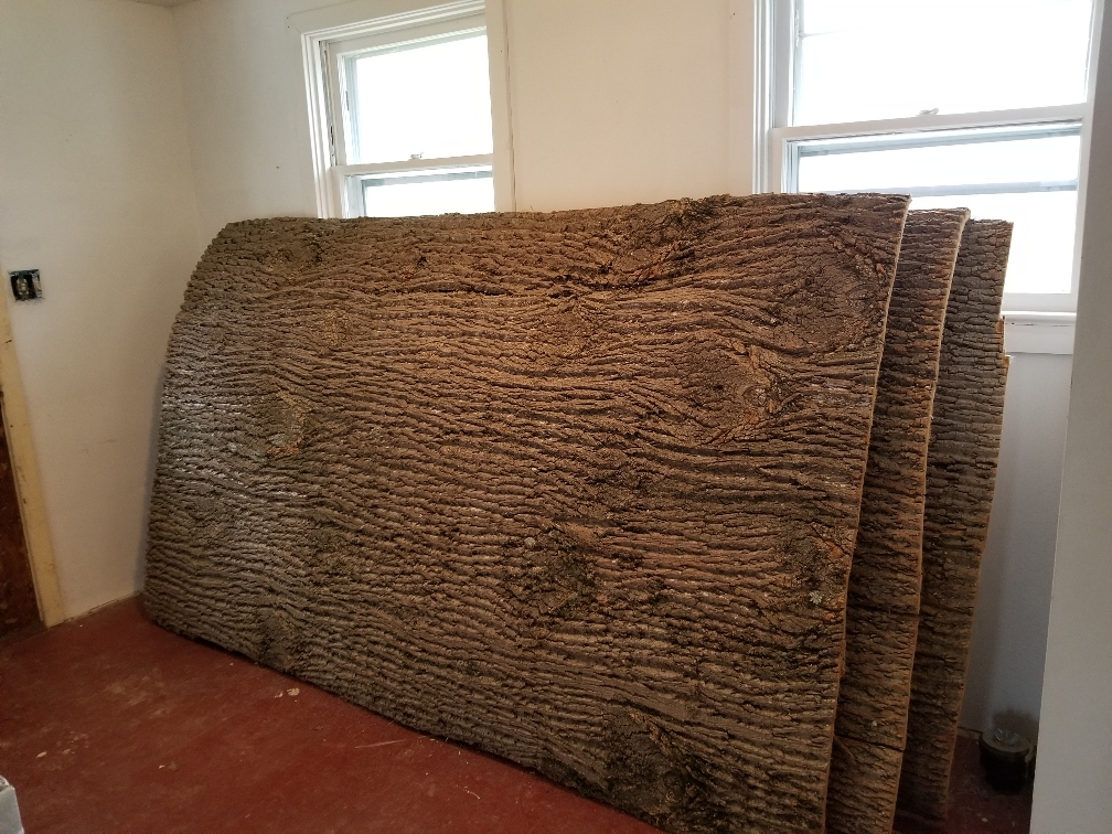

Well this is part of some trees I cut. Peeled the bark, dried it and going to use it to cover a wall or two in my new place.
That's awesome, how did you get it to peel without breaking?
That's the tricky part. Cut it in like june when the sap is really pushing. Take your time cut a ring around it at your desired legenth, and a straight cut legenth wise then a stanley wonder bar to peel it off the log. We have a big basket for on the front of the skidder. Carry it carefully to it. Put a pallet or 2 on the garage floor and lay it on it, lumber stickers in between. Another pallet on top and ratchet strap them tight.
