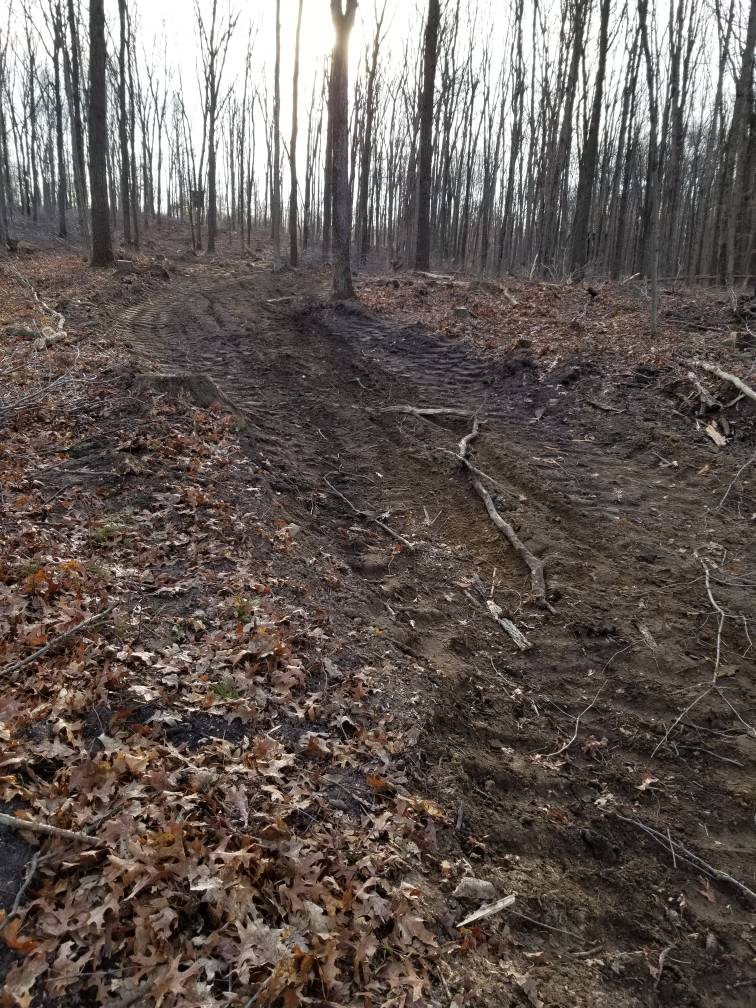

Its really starting to dry out. This is odd ground were on, its about 5 inches of topsoil and then sand for as far as you can dig with an excavator. Saturates fast but dries fast aswell .
The clay ground up here is still wet as hell. More rain coming tomorrow, so that's great.
