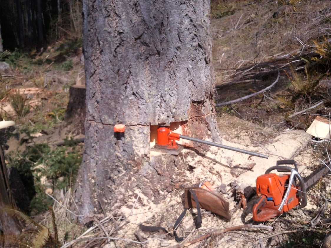

I’ve got a hydraulic porta power with a 30 ton head.
I’d really like on of those jacks from Madsens but I’m not payin 2 grand
A 45 ton Silvey or Borntrager jack takes a hell of a seat to fit in the stump safely, but the good part is they are self contained with a pressure gauge and check valves internally.

What kind of jacks are you guys using?
One of mine, 45 ton with 1” aluminum plates bolted on. Always make sure the foot or the top has movement. I’ve owned a set of Silvey tree savers the big ones the foot was what moving piece allowing them to stay flat in the cut, but they take a hell of seat in the tree the smallest tree I could put them in was 28” the plates were 10” alone.
