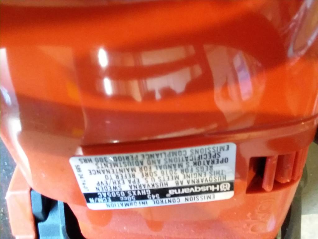

Almost new 545
I don't think it's got a tank thru it
Guy got it with a Zero turn and didn't want it
