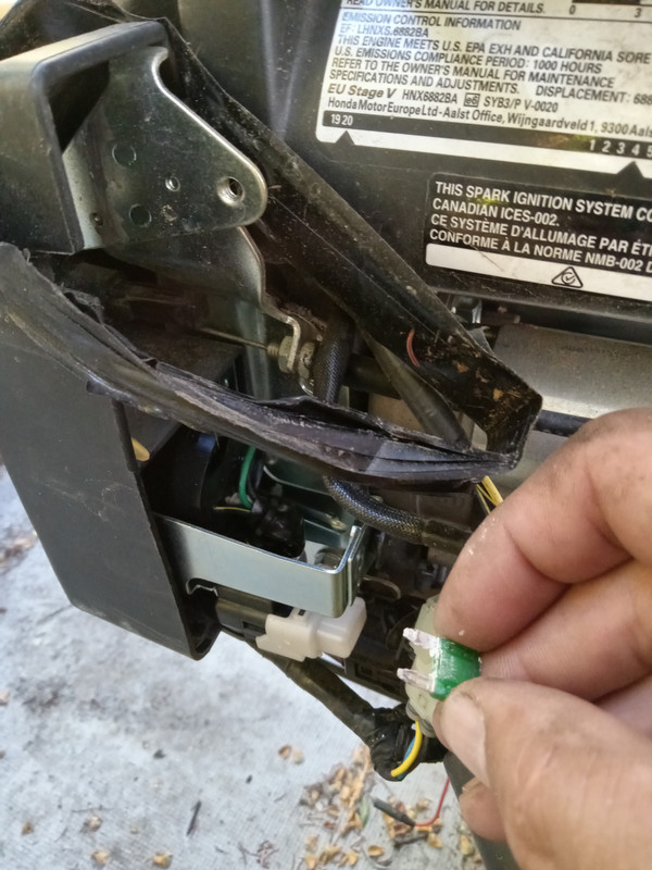

How many hours on your Honda gx v-twin?
Many commercial pressure washer guys and mud-motor folks have had issues with electrolysis corrosion on a mini fuse behind the ignition switch at about 100 hours of use. I suspect two dissimilar metals between the fuse slot and the fuse. It gets so bad, your engine won't crank over. BUT, it is usually never that nice denso starter.
Anyhow, pull that fuse and replace once a season. Fill fuse slot with dielectric grease bud!:
*my fuse at 120 hrs. No-start issue honda gx 690

Yep that noalox is good stuff for aluminum. When I had first pulled the fuse, the inside of the fuse was so caked full of electrolysis corrosion, a new fuse was needed.
Forgot to add: fuse slot will always be clean, and sprays out easily with electrical cleaner. But the fuse itself almost acts as if it's a sacrificial anode (like on a boat motor).

It only has about 85 hours on it. It sat over the winter a couple of years ago and I had to replace that 30 amp fuse.
