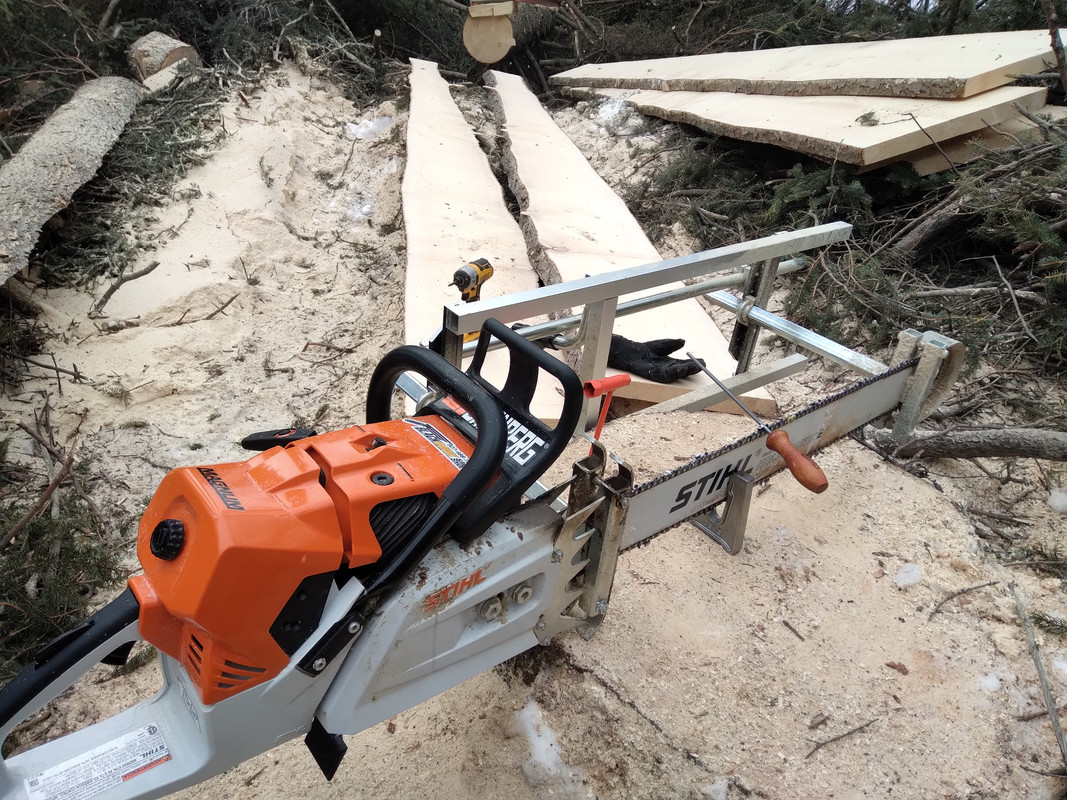

PA Dan
FYD
5:14 AM
306
7,372
36,705
White Oak PA
Milled some Walnut yesterday with the Stihl RMX 3/8" .050. Smoothest cuts I ever made.
