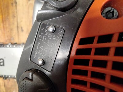

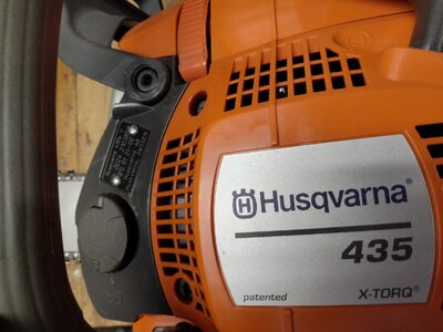

I’ve looked at a few ‘s’ 400 series at Tractor Supply and there is no riveted serial tag. Where is the serial tag located on these saws?
Do you remember which series numbers they were? I have a 435 from TSC and it has a serial tag in the typical spot, I had a 455 from them also, but gave it away so I can't check it, but pretty sure it also had a serial number tag too:
