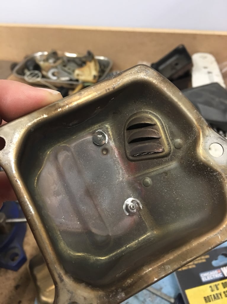

Oh I get it now I’m trying to get the tube out instead of taking the whole inner shell Out of the 2 piece shell that I’m holding. [emoji849] duh
I guess you missed the post i put with the cat out . Yea....its a load ! of work taking out the tube or even just the cat material from in the tube.
The mounting plate your left with if you do not take the hole thing out still gets in the way and blocks off getting to the gilled opening.
I like leaving the gills in place and with a large flat screwdriver , bending them more upright. If you do not like just doing that then its simple to grind them away.

I didn’t miss your picture Simon I saw it and I guess I was still just focused on getting the tube out not realizing that you took the whole plate out. I was wondering why the tube still looked attached to the plate lol. I saw the spot welds on the tube and got stuck on that. It was late last night and I’m not even sure why started doing this last night I’ll pick up a proper bit for my Dremel and finish it when I get home from work.
You were clear I was just being dumb. Lol
No Mate , you weren't being dumb . My first cat dell on the 420/421/4300 a while back I did the same as you ! :D....thinking the tube had to come out and didnt see the spot welds thus not making the leap towards the easy way . The Stainless muffler seem to stand up to a bit of grief levering out the bit you dont want but just try and keep the border in good nick.

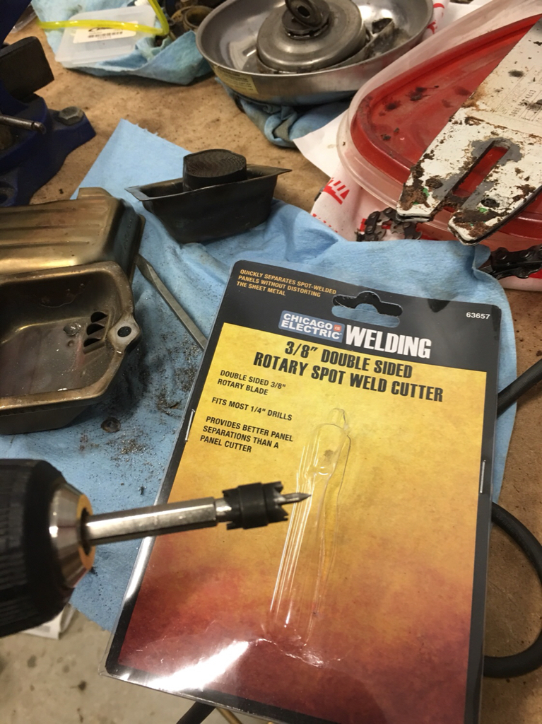

Came home from a long day everyone in bed. So I found this Little gem at my local Harbor freight within five minutes of being careful not to go too far with it popped right out
Thanks again. The 4300 says thanks too she can breathe better now. [emoji1]
:eek: I’m buying one of those asap lol
Very handy tool ....whats the plan now you can see and get at the gills ?
