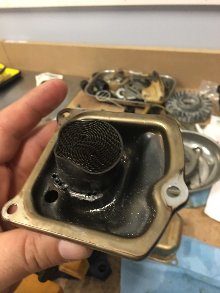

Well apparently I have to get some new Dremel bits I’ve got three spot welds holding this 4300 cat. I’ve got one pretty much gone but I can’t reach the other one what did you use?
There are only two spot welds. You can kind of see where I ground away on them where they were in this picture...4115323C-DCC6-46C1-A01B-2BD4E3851F6C.jpeg

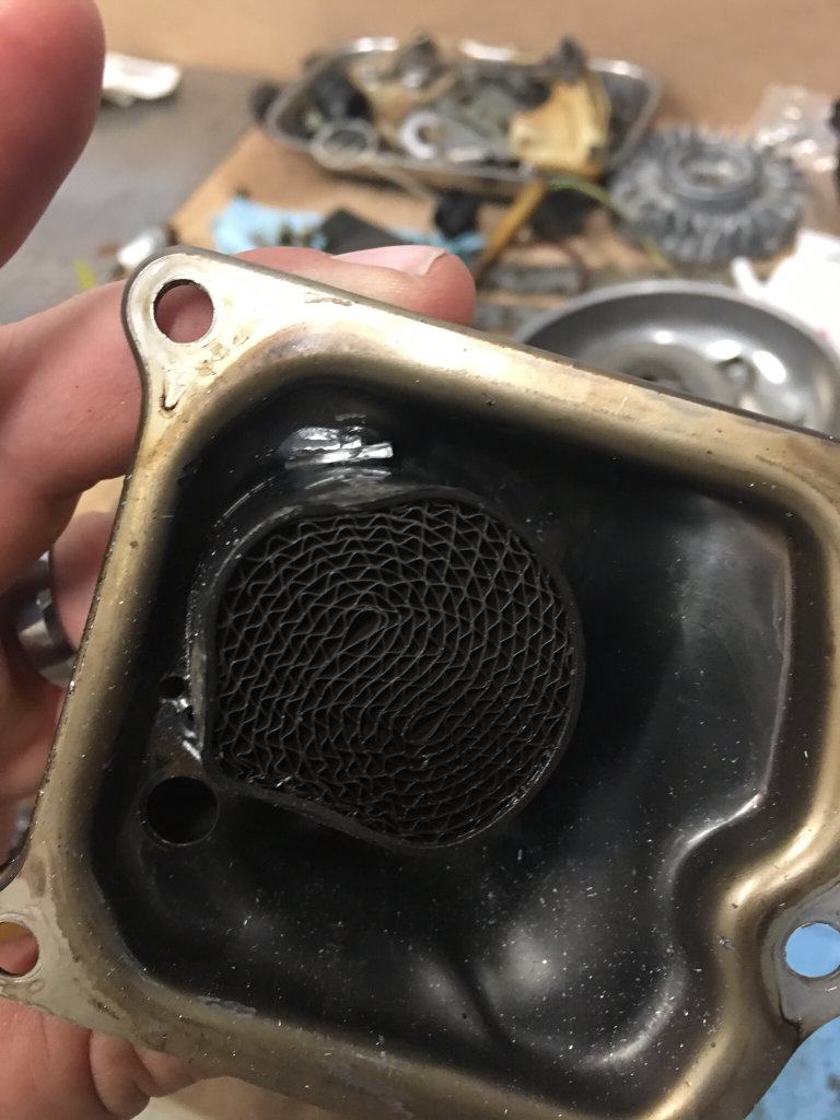

I was hoping for two but there’s three for sure and it’s the top one that I can’t get anything really down there except for a drill bit
There is two on either side of the cat tube. They hold the entire assembly half. Pry it at the seam once ground out and it pops out. 344295BB-F892-4A56-A2ED-F1E7CA19B5E1.png9A60075F-CA56-46AA-96AB-9AE991C53A51.jpeg
