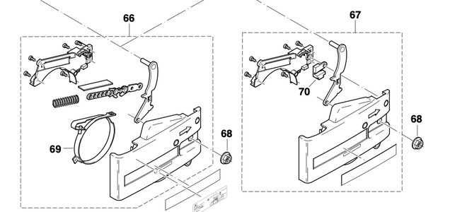

Interesting, according to the lists I have the "DE" models don't have a chain brake, but maybe there have been different configurations for different markets.
The chain brake is in the side cover. Am I right in thinking these are based off the 100S?
The chain brake of the 100S is different. This one is like PS-340, PS-400 et al.
It seems that this saw is not simply a version of the DE3435 with a 30 cm guide bar, as is often the case in such designations. It is not listed in the manual for the DE3435/DE4040. Nor does it appear on the parts list for these models.
It appears to have been an independent model from the DE3435/4040 (with brake) and can only be found references to it on Japanese and Australian websites. Is there perhaps a manual or parts list somewhere that includes the DE3430?
