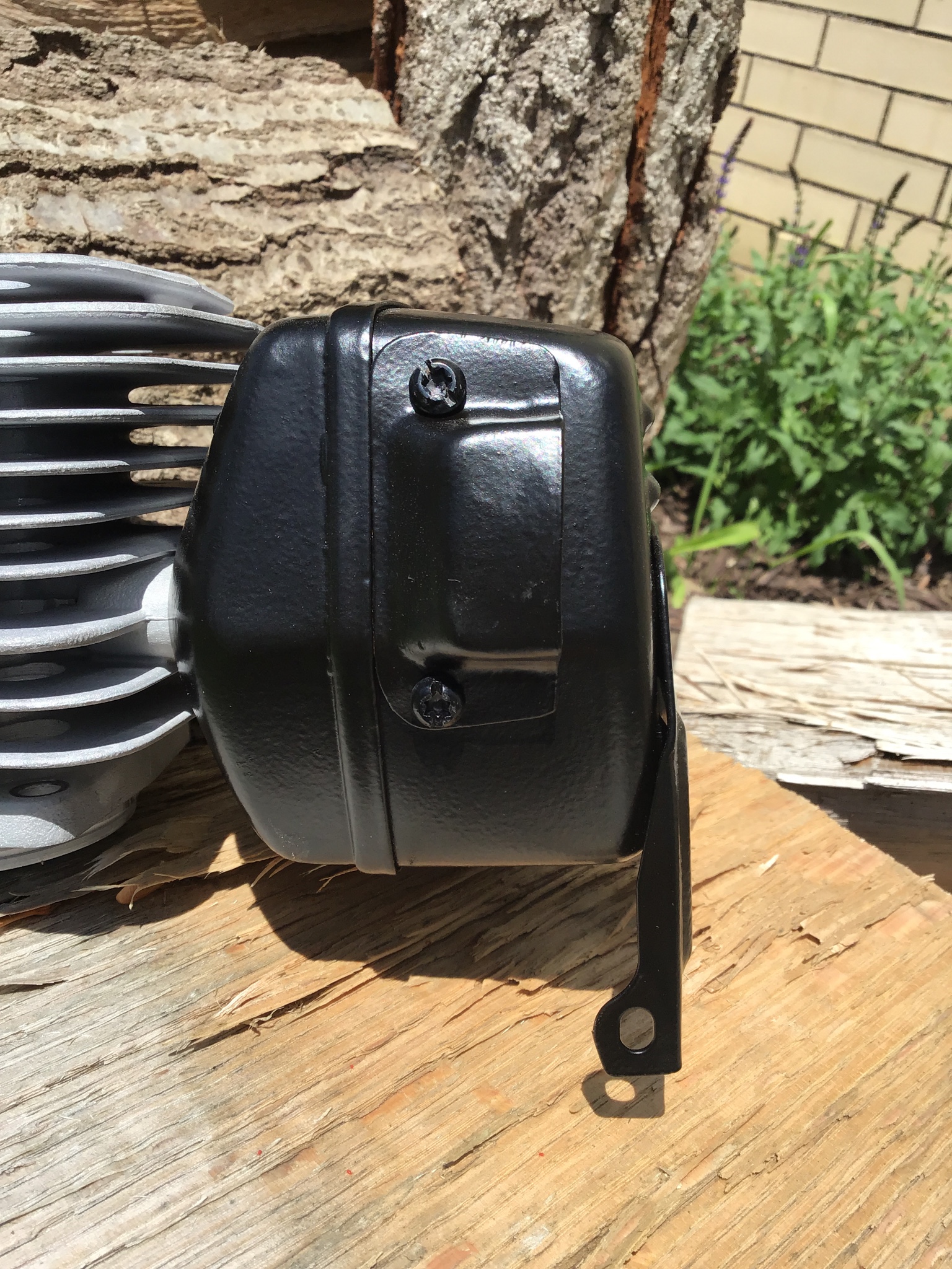

Here’s one I used on my 281. Not sure what size it was but it’s perfect now.

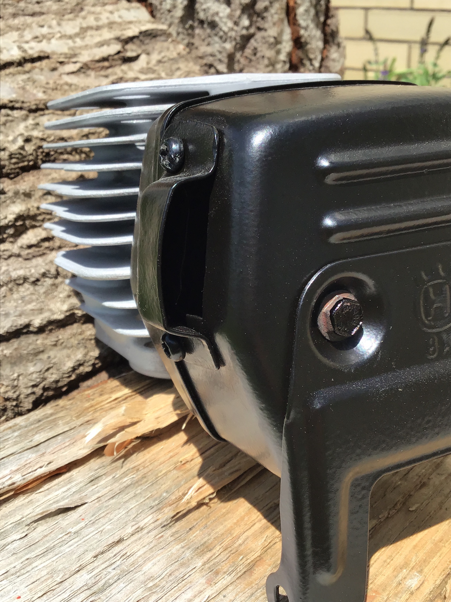

I’d love an assymetric opening on the front, where the top is narrower to the muffler body than the lower portion.
On the Stihls I do, I find myself having to crush the upper portion in a bit to clear the brake. Sometimes the brake will self clearance itself by melting, but I hate that.
Similar width as the stock stihl deflector?
You make the deflectors look right at home on your builds...
Don't need no stinking 288 deflector..
Looks like a medium very nice finish.
Thanks! I use a 3/8 extension and a hammer to flare out the deflector to where I want it. The finish is high temp black by @Glock37! That muffler is dent free and looks better than new! I cut the baffle out that was under the stock deflector so she should breathe pretty good!

I was thinking one with this angle rounded. On some models, it hits the brake.
Honestly, this can be done by the end user and I really see no reason or room for improvement.
044
Was having a hard time making a medium fit this 660 and gave in to using a small, so I see what you are saying.
