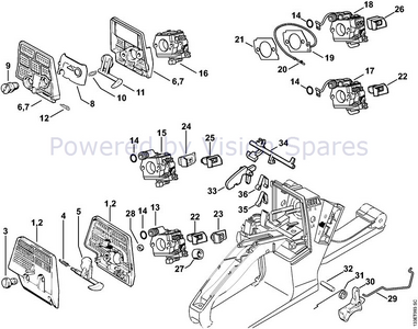

Nuts on an 026 filter are also part of the cover attachment design. 260 filter will give it more air flow but the nuts don't work with the cover. You also will have to clearance the 026 cover to work with the 260 filter in addition to switching out the nuts.
It does appear that the air filter does have pockets for nuts?
