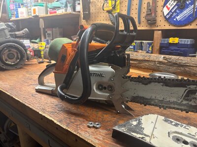

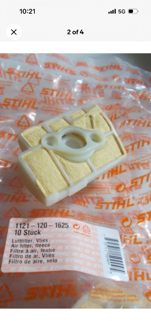

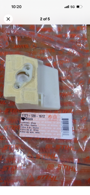

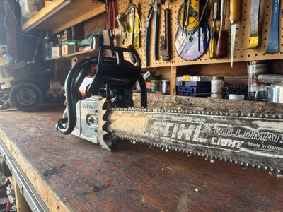

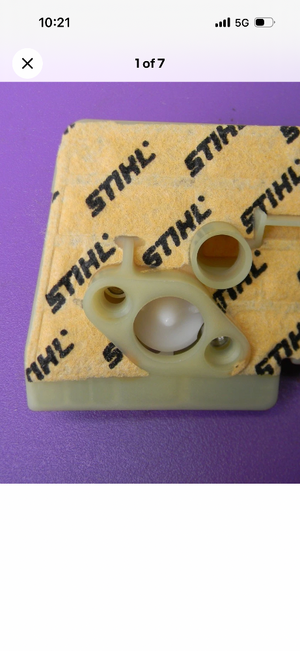

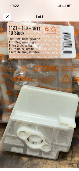

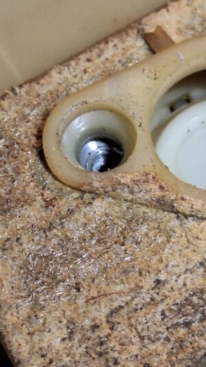

Various photos 024 filter,024 super/026, ms 260 all have the clearance for 8mm carb nuts and all are oem filters. 260 uses the tab to hold cover on vs filter screws.

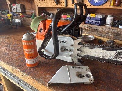

Well I shot it with some Stihl grey. Not sure how it will hold up. It probably won’t last. But it looks pretty for now.
When the boss isn't around I put such things in the oven under 200 degrees for a while. Seems to harden the paint a little. I don't know what I'm doing.

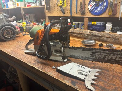

Had an 044 gave to me with a broken flywheel case of which I had an extra one that I had powdercoated by Shaun in a box sometime ago. Rebuilt the saw it runs very good but I noticed it had a Walbro 18B carb on it. Never seen an 18B on a 044/440?

I looked it up also and it said it was on several saws.
MS 440
Compatibility
: It is listed as compatible with the
Stihl MS 440
and
MS 460
by various aftermarket parts suppliers.
