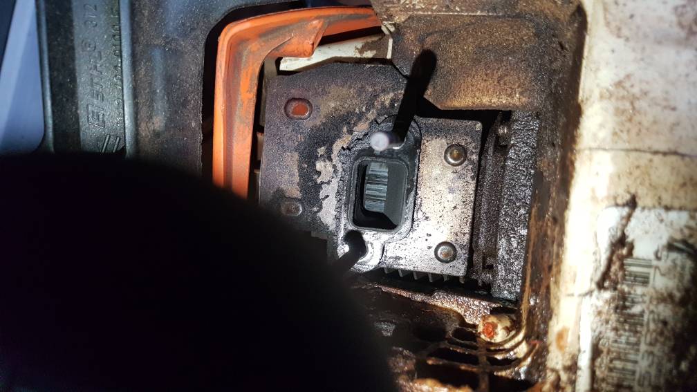

MS250 scored piston , 75 lbs compression, starts and runs great till to try to cut wood ....
No power
No power
Sent from my SM-G930F using Tapatalk
Dang I would say scored, how do ya think that came to be that way? Is it Sooners or cowboys for you?

A guy brought me this saw , starts and runs great, just no power lol
I may order a jug and piston and port it up
Good year to be a Sooners fan, been one since the Boz played for Switzer, been to a few bedlam games in Norman. Do you think straight gas could cause that much damage to a piston or something got in cylinder? Just curious
Don't know
To lean and lots of hours I think.
Guy did not want to spend that much on it.
I think I'll rebuild it and do a port job

I'm not so sure you can do much with a 250 .It's obviously not hung .If it were me, which it's not I'd get transfer off the cylinder, sand the piston, new rings ,gut the muffler and call it a day .Plus I'd run 32 to one mix ,which I do anyway on all my stuff .If it runs ,fine .If it tosses it's cookies you are only out your time and the price of a set of rings .

I agree with Mr Smith, although my mix ratio is different & I use ester synthetic oil ( Motul).

A set of rings is 20 bux and the piston w/rings is only 30 these days. Pays to price check with Stihl even when considering going cheap or aftermarket.
31 bucks from Sthil , probably the way I'll go , oil pump may be bad also , I'll check pressure and vacuum also
