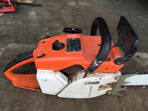

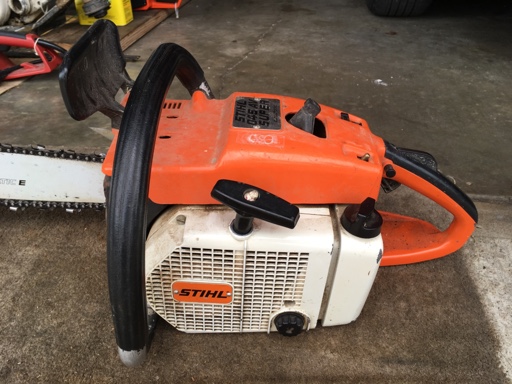

Fellow offered this to me yesterday.
Very nice low hour 045AVE.
I passed mostly because the ignition can go at any time.
Curse you Baron Bosch !!
If it was a Bosch electronic ignition I would have snagged it. The main version (electronic) of the Bosch ignitions are totally fixable if they fail. There is also an aftermarket Bosch ignition module from a German company called Saegenspezi, though I believe they are intended to revive the older points ignitions. Not sure whether they offer a replacement electronic module.
A bad SEM ignition needs to be replaced with another SEM or converted to Bosch electronic (incl flywheel) for renewed spark.
I don’t need that grief.
[emoji2960]
I have an 056 with a bad Bosch now.
If I remember correctly, there is someone on Epay repairing SEM ignitions.... a bit on the spendy side but might be worth it when other options dry up.
