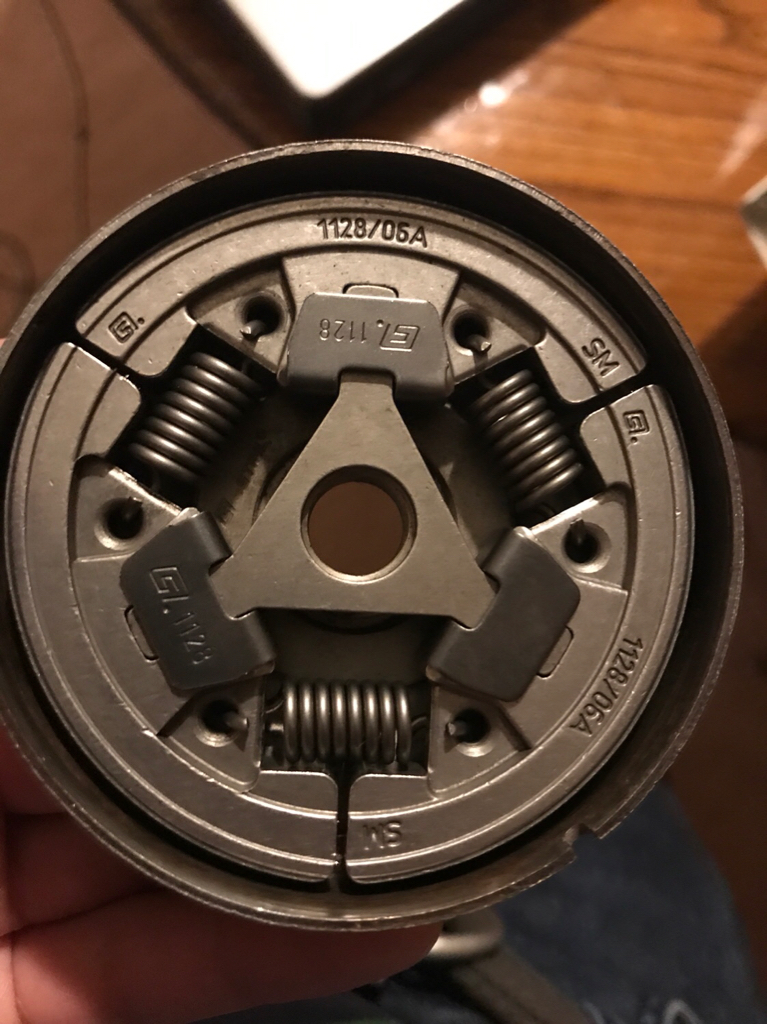

Are Stihl clutches supposed to have this much space between the clutch and drum. I haven’t noticed this much space before.
What's the part number on that drum? Does the number start with 1128 or 1122?
