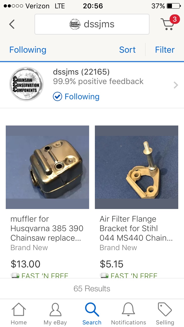

Ok, thanks. I will be happy to hit him up for parts.
If you run the eBay App,
He looks like this:
