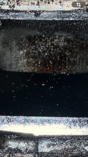

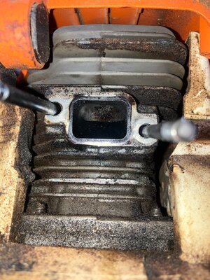

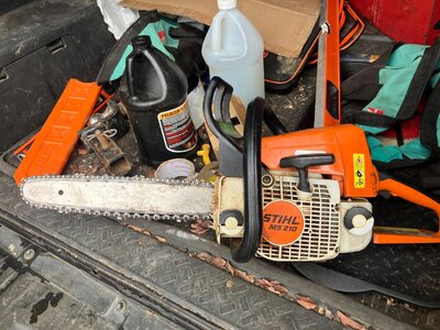

Picked this little saw up yesterday for cheap on CL close by. Seller said it started and ran well till it warmed up. It’s ran great for me so far. Holds idle upside down and sideways. Piston is gunked up but still has machine marks. Appears unmolested and well cared for. Anti vibe chain took a minute to sharpen.
If it does start cutting out, anyone know what it might be?

Could be a bad tank vent, fuel line, or carburetor diaphragms. Often, poor fuel pumping is the cause of running well till warm. At cold start and until a certain point, the volatility of the fuel creates pressure on the tank that masks a poor pump. But after running for a while, the pressure drops and then a poor pump or metering diaphragm will show up.

The guy said he put an AM carb and fuel filter in. Didn't change anything so he put the original carb back. No mention of it being rebuilt or not. About 55 degrees this morning I made a few cuts with it and it ran fine. Might be different in hotter weather. Idle speed occasionally increases a touch but does hold well. Think I'll call it good for now and give it a bath, new chain, muffler mod and timing advance.

Turns out it was a dirty armature.
