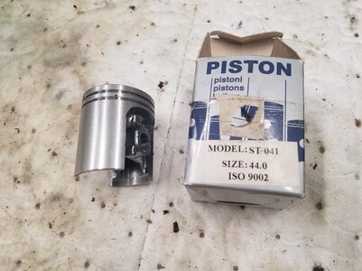

Someone left me this 041 parts saw a few weeks ago. It felt like pretty decent compression so I thought I'd try to use the short block on my 041 Farm Boss with the plain aluminum bore since finding another chrome plated piston has proven to be very difficult.
However, I found the "flange" on the PTO side was badly cracked.
So, I decided to pull the cylinder and see about using the piston and cylinder on the FB. Plain aluminum bore on the left, chrome bore from the dirty saw on the right. From the marks on the castings, I am guessing the plain bore cylinder was indeed an OEM Stihl part not an aftermarket piece.
I was going to use the new piston so graciously provided by Powerstroke Cowboy, but ran into an issue when I discovered they forgot to cut one the the retaining grooves for the circlips. If anyone has a suggestion for cutting the groove with my very basic tool and skills I am eager to hear of it.
For now I will revert to my original thought of using the piston from the parts 041 and see if I can get this one together and running.

Far as the piston circlip grove I think it could be done on a lathe but would be a lot of messing around. If you have a 4 jaw chuck you could machine a fairly tight rod or tube to run through the piston wrist pin bores. Put the piston in the 4 jaw chuck and use the rod to center and true the bores with tail stock. Then make a custom high speed cutter to make a groove. I’m sure this would work but would require a bit of messing around.

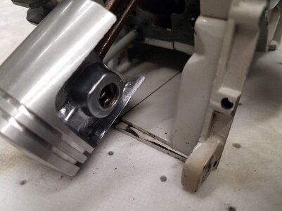

With a little help from Chris pointing me in the right direction, I came up with a way to cut the groove for the circlip. I have a mandrel that closely matched the wrist pin size so I was able to secure that in the piston, the piston in the lathe, and modified a boring cutter to make the groove. Certainly not NASA tolerances, but good enough for a 1960's vintage chainsaw.
The saw now starts, runs, idles, and oils as it should, in fact the oiler is a bit too generous. Nice project to have done. The 041 is in reality a very simple saw to work on. I'm not sure what happened at the end of the video but you get the idea.

With a little help from Chris pointing me in the right direction, I came up with a way to cut the groove for the circlip. I have a mandrel that closely matched the wrist pin size so I was able to secure that in the piston, the piston in the lathe, and modified a boring cutter to make the groove. Certainly not NASA tolerances, but good enough for a 1060's vintage chainsaw.
Mark
The big orange knob is for the oil output, one thing with the 041/051/075/076 is the oiler design gos into the case and uses some orings ro seal the bar oil out of case. If they ever start to smoke real bad it usually the o-rings on the pump that broke. Very cheap fix if it ever happens, not that you’d be running the farm boss for much anyway.
The 041 of any variety is a nice sounding saw I my opinion, my uncle still cuts 10-20 chords a year with his farm boss he bought new in 1981 still runs mint, only time in shop was for a cracked back handle that he had changed and I put a new carb kit and fuel line in it about 10 years ago.
