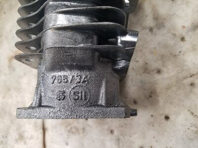

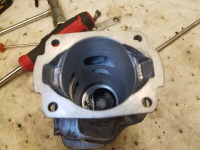

I received this piston today (Thanks @Powerstroke Cowboy), which led me back into the 041FB.
I was rather surprised to find the 041FB has a plain bore, not chrome plated.
The original piston appears to have been chrome plated, most of it is gone.
So now...
I must assume the replacement piston is not chrome plated??
I dare not run a plain piston in a plain bore...
Is there a source for a chrome plated piston today?
Am I all wet here?

Mark, ive never seen a plated piston for the 041fb. All thr cylinders have been plated though.
The Kolben piston you have is a OEM piston.
Hopefully someone has an awnser for you.

While I had it apart I took a few photos of the cylinder that was on the saw. From the markings, I would certainly guess that it is OEM.
I also found a You Tube video that mentions the aluminum bore cylinders (about 45 seconds in).
For now I just put it back together and will find a spot in the display for it while I continue to investigate pistons and cylinders.

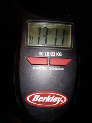

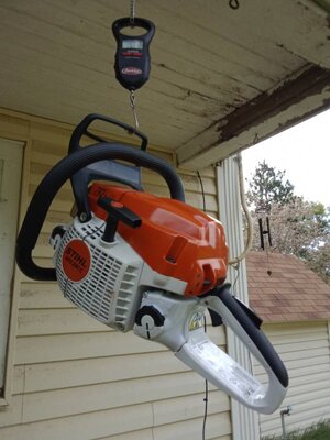

4881
Dec 25, 2017
311
861
MN
For Science, B.S and fun
Do we have a weight watchers thread?

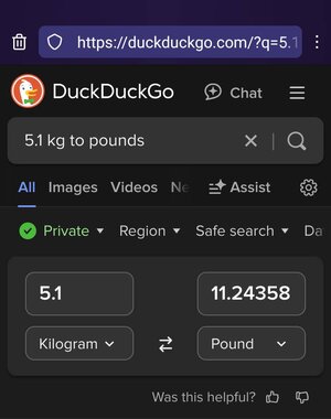

Fresh out of box unfueled, unmolested dom 03/24 Stihl MS261 Arctic weight add 1 oz for factory spike not yet installed. So #11.8
So checked the manual and it gives 5.1kg for Arctic model. That's #11.24 my scales not for trade but ballpark seems reliable enough.
Overcame the 1lb and a little more by going from 18" .325 .063 rollomatic (plain Jane wears for #14.6). To a 16" .325 .050Sugi-Hara #13.11. Was late so living room doorways a little dark.

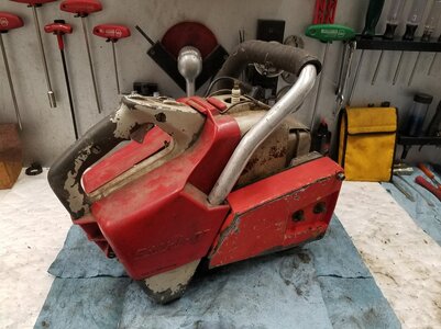

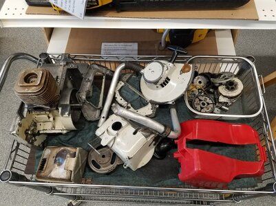

07 getting a thorough going over. Ideally I will get this one to run, take it to a few GTG's, then find a permanent home for it in the display.
@Jay Hansen has already contributed a clutch cover and the handle bar.
This saw was ridden hard and put away filthy.
All cleaned up now.
I noticed during disassembly that I am missing one air filter and retainer knob. I have a parts 08 on hand with spark that will have to give up ignition bits as the 07 is missing a few things.

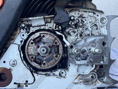

Hi all, new here with my first Stihl MS 261C 😊.
Just bought it second hand it looks good but it’s covered with a lot of dirt. I want to do the best I can before run it. I’ve removed the spring and the brake in order to clean around the clutch better (see photo). IMG_2458.jpegIMG_2457.jpeg
Can someone tell me is there a specific way for assembling the brake because of this little piece inside (I think it was for splashing the oil).
And how to clean on the other side - it’s not gonna disappear only with compressed air 😕
p.s. All the engine is also covered.

That’s the tab on your oil pump worm gear that drives off the clutch so it only pumps oil when chains moving. It’s not going anywhere when you spray out the clutch area. Be careful of the crank seal behind the clutch and don’t use any harsh cleaners that may eat that seal. The little part you see is the end of the arm on this picture.
