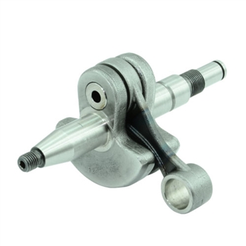

I just need a crank for a 261, got one here that’s nice shape that I bought as a parts saw but lower rod bearing is loose
Might have one. Will check my 261 box.
If @Woodwackr doesnt have one, HLSupply has aftermarket ones for relatively affordable, if you want... i have had very good experiences with them, and they are site supporters

1141 could be a261 or 271/291, but usually the bearings are still on 271/291 cranks due to being clamshell so i would say its likely a 261 as well
Never gotten to looking but has anyone compared a 271/291 crank to a 261? What were the differences if they have..
It came out of a 261.
I thought the 1141 was odd
