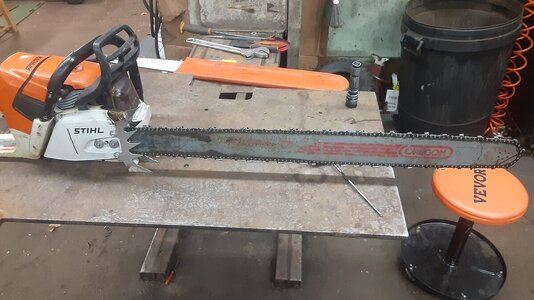

So in digging around the day after this video, i happened to find a 36" roller nose sitting in the attic... happened to be a d009 mount, so busted out the rotary tool and carbides, and opened her up to 12mm.... and voila... we now have a roller nose bar for this sucker... which, my suspicions appear to be correct initially, that the ole hardnose was burning off a lot if oil, as i had to turn the oiler way down in testing this bar for fitment, had oil errywhere....LOL
Not sure when the next time it will see wood is gonna be, but im looking forward to it...LOL
