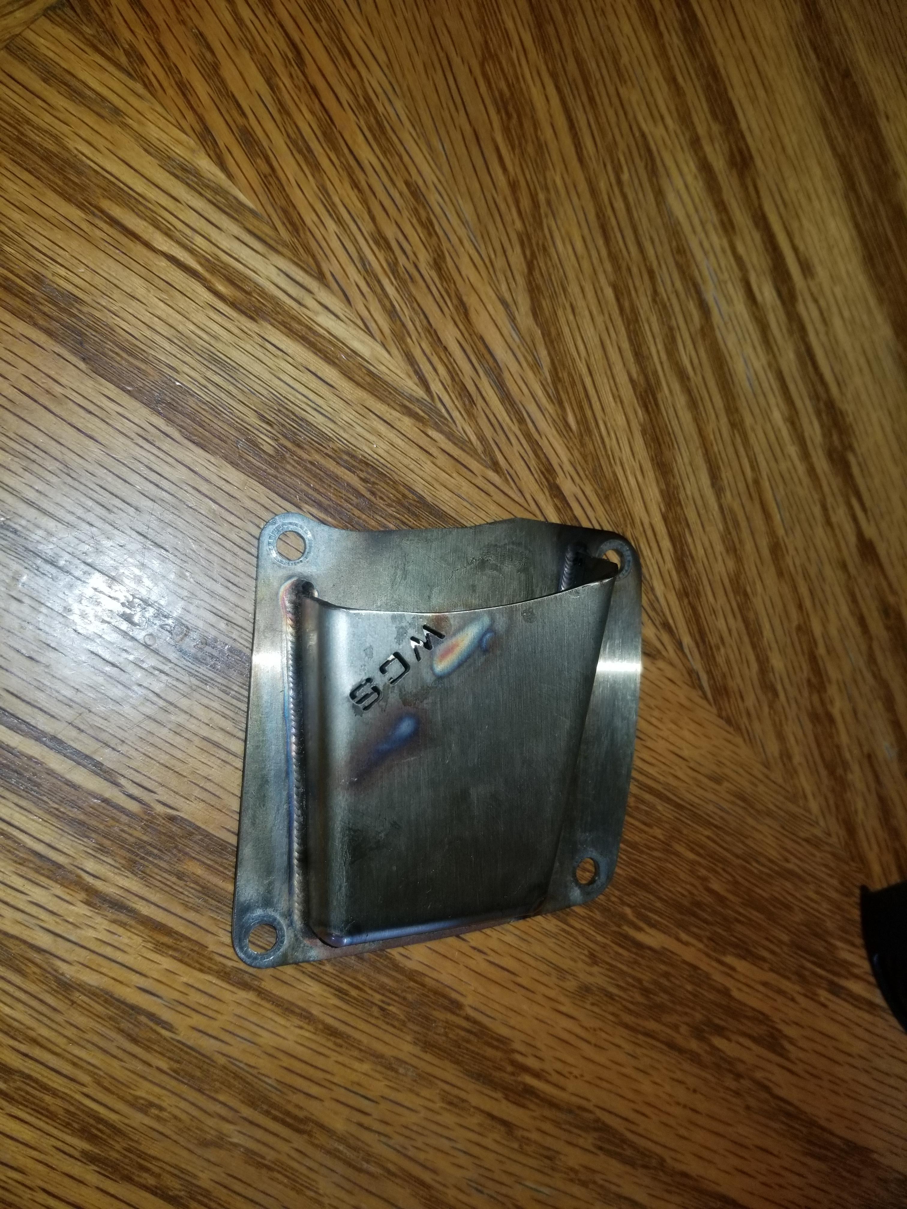

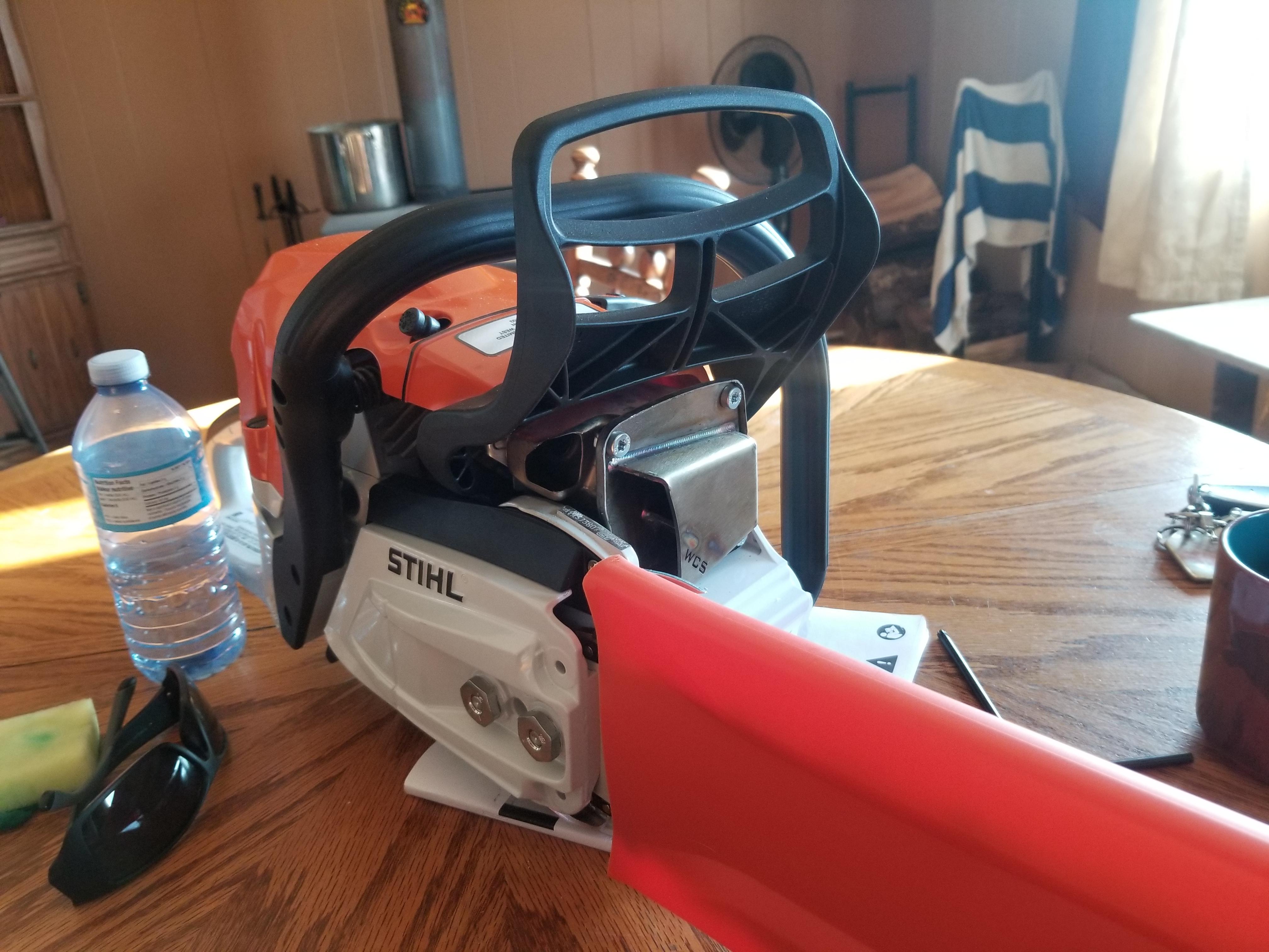

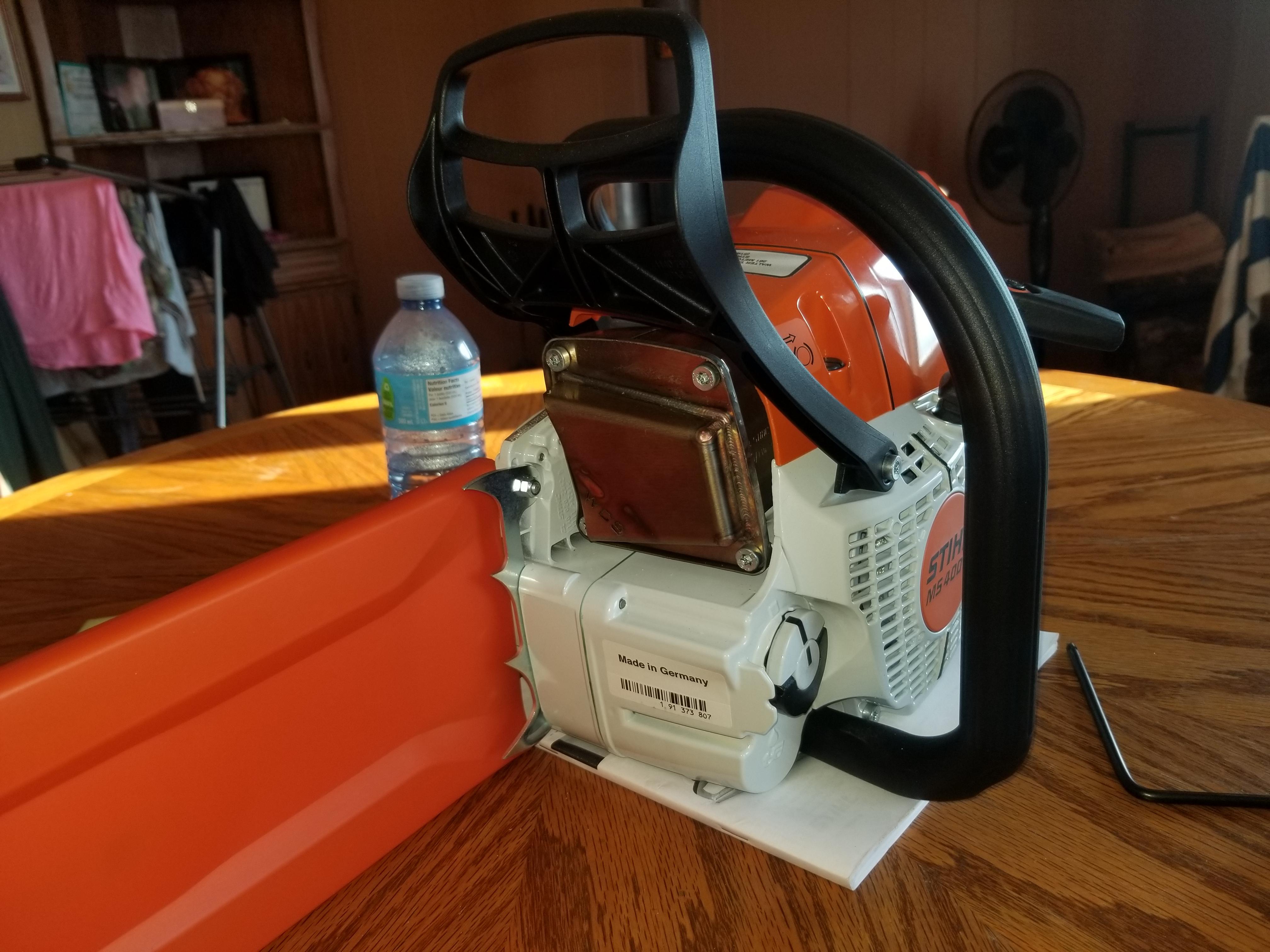

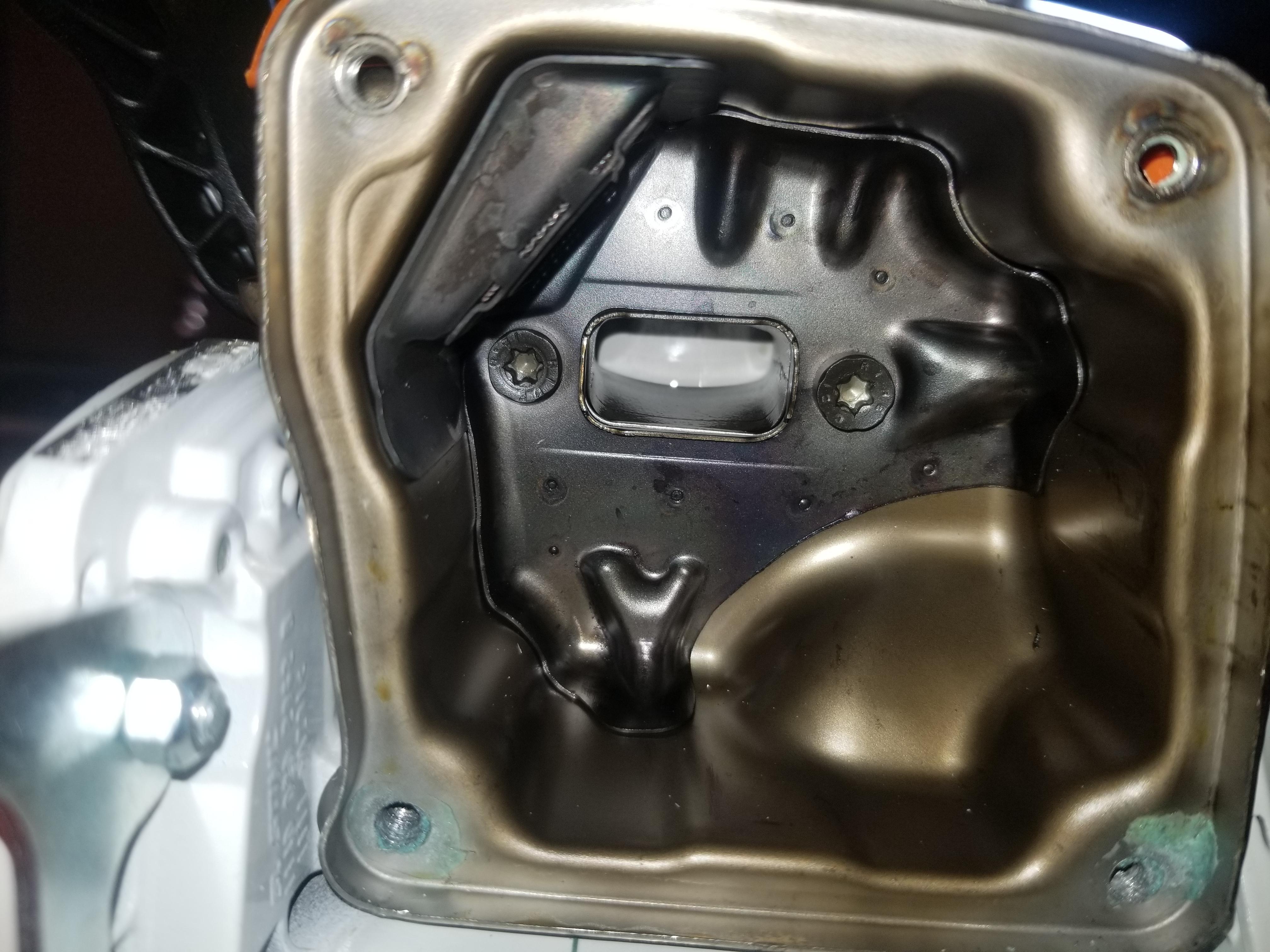

Coupla shark gills in the OEM front cover woulda been my approach for starters. That barker is gonna wreak havoc on the case.
merc_man
merc_man
10:01 AM
933
Feb 24, 2016
5,012
21,830
southern ontario
cut the can volume almost in half
then blow ex at crankcase
i'da run it stock first
then maybe open it up a little
just my $.02
I will definatly break it in with the stock cover. I just wanted to see how it looked.
The cover does not blow it directly on the case. It has a deflecter to direct it up on about a 45 degree angle.
