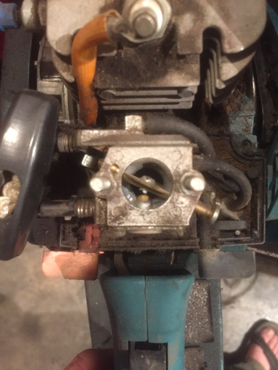

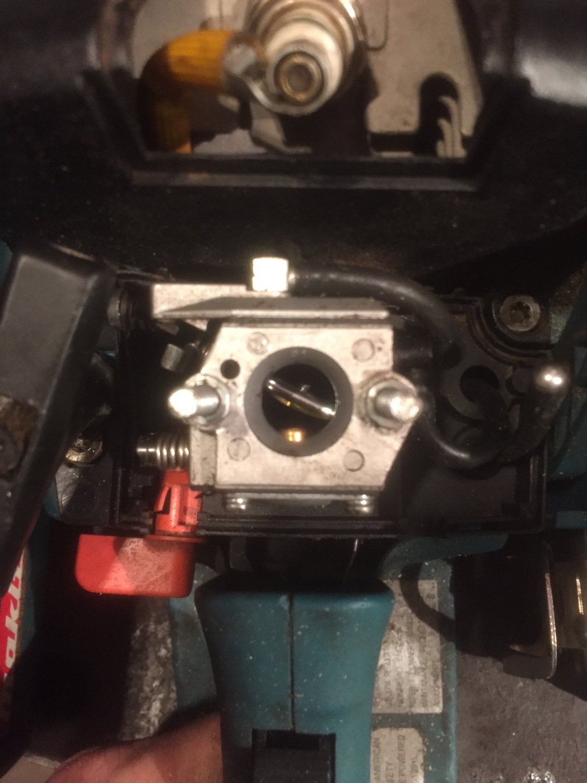

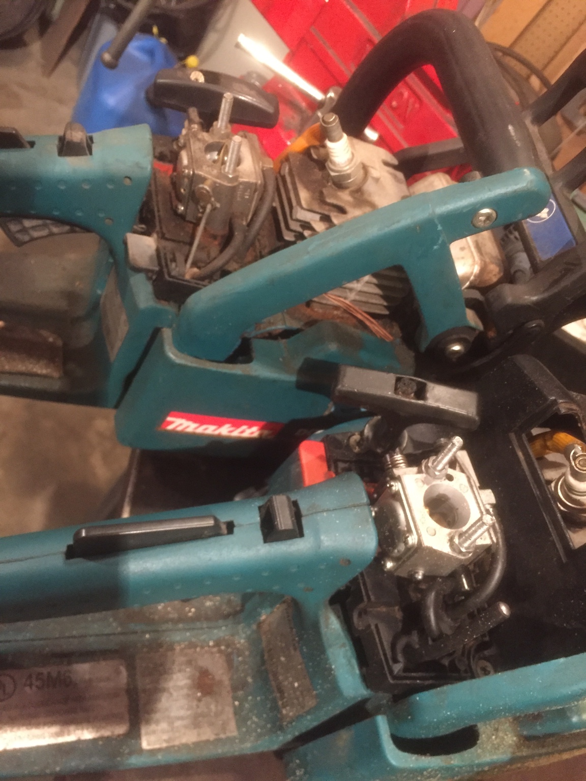

Just because you guys are talking about the biggest dolmars...
How about a baby saw project?
Little makita 401, 40cc got a carb upgrade. [emoji48]
Trying to figure out a new choke mech.
Best thing is everything lines up with OEM hood!
Got a couple poleman carbs a while back and they will be getting installed soon. Already put one on a friends 7300 and what a freaking difference it makes! I hate zama's but this one ran pretty dang good!
