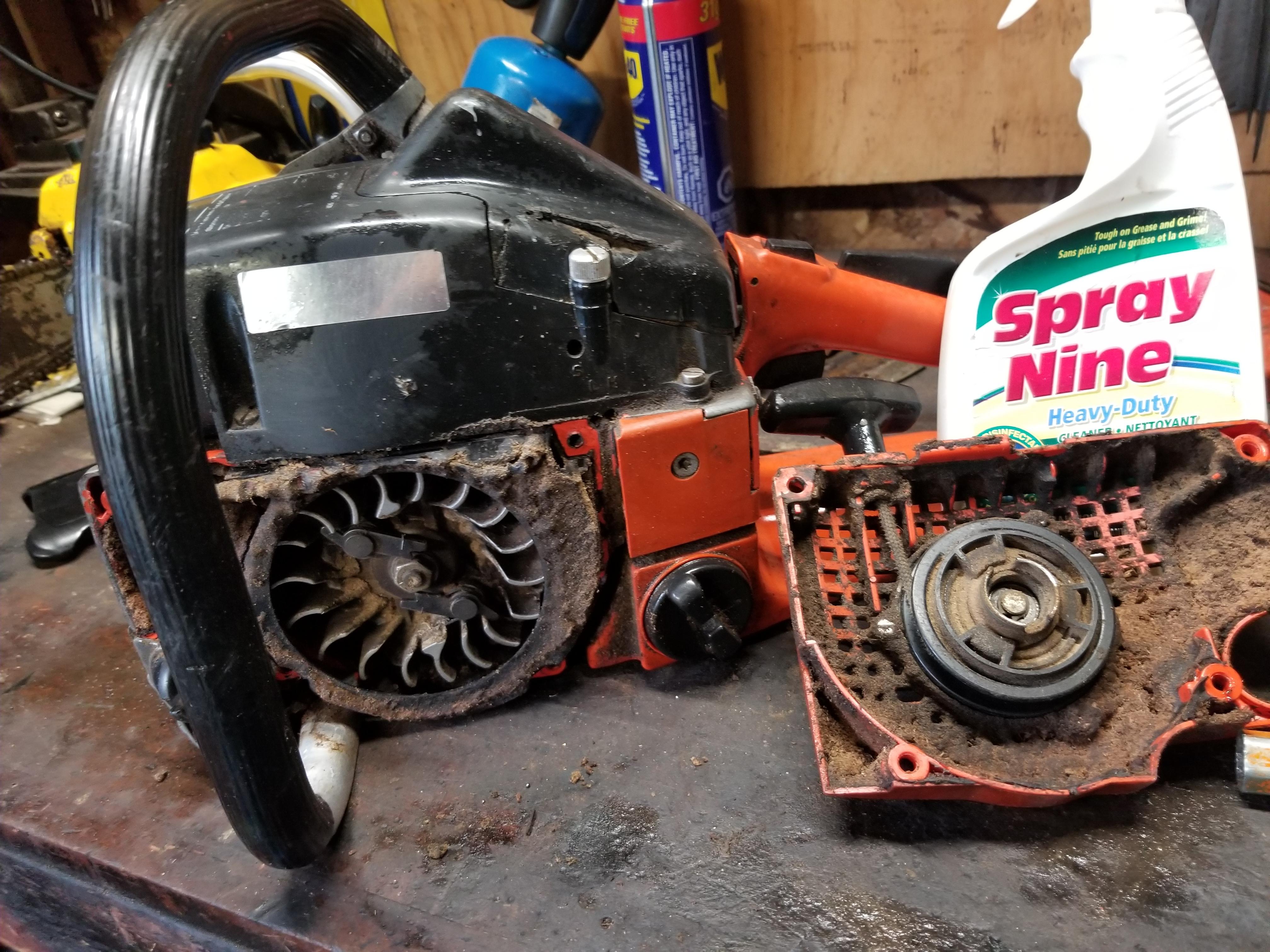

Oops, looks like the flywheel is enjoying the inner part of the emblem. I failed to notice the openings on the cover when installing.

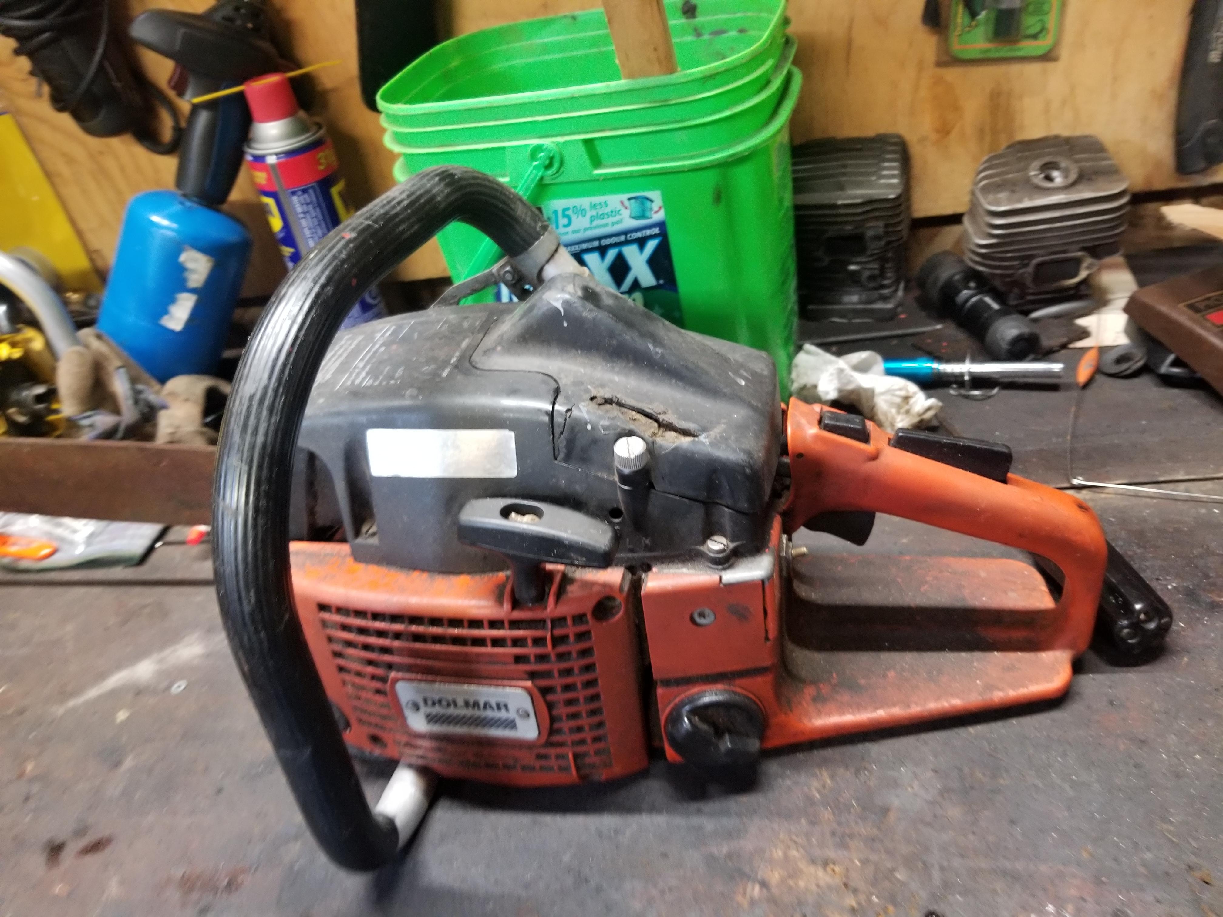

Its alive after a little tlc and lots of cleaning
