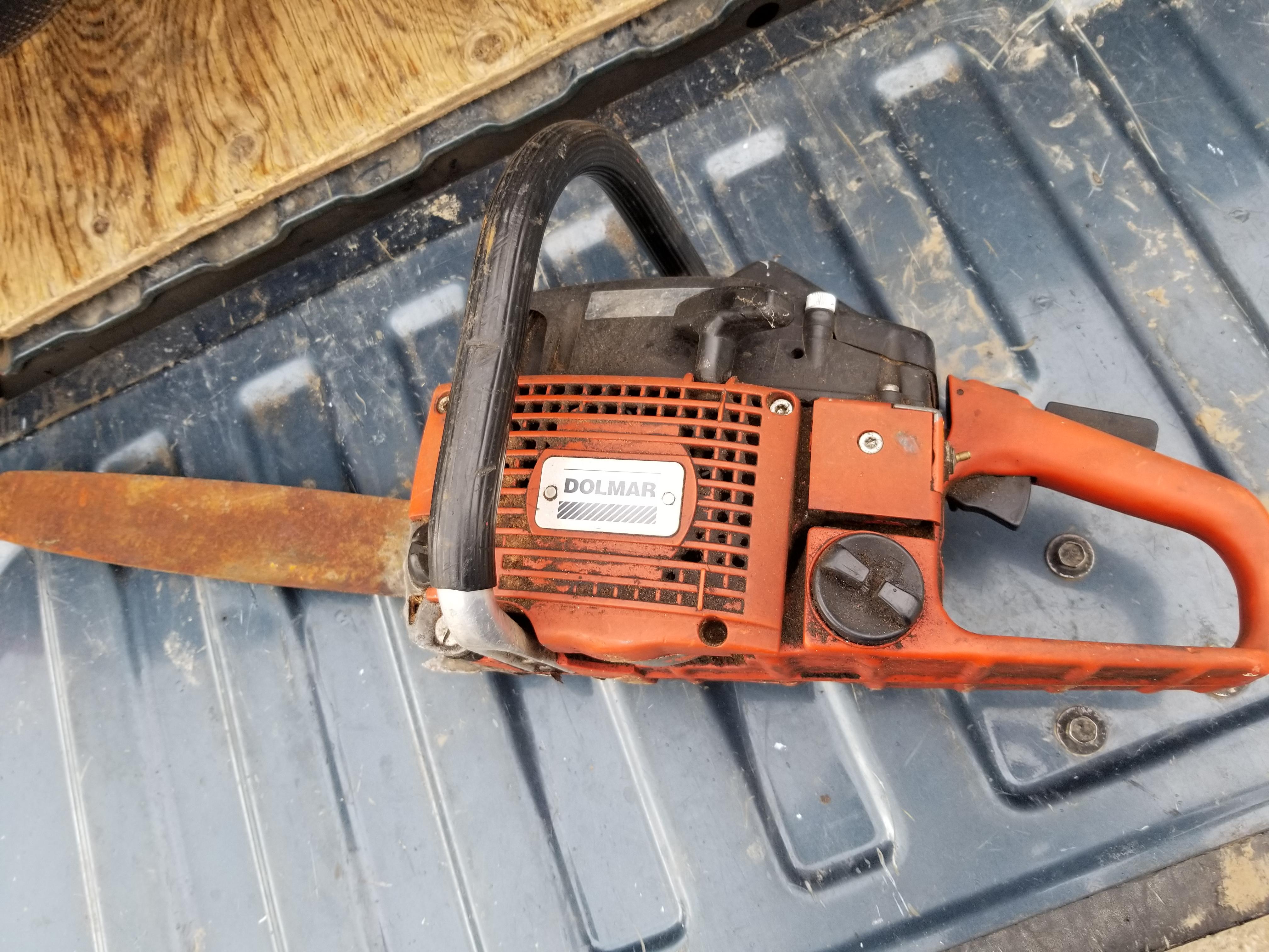

Little dolmar to add to the collection. Buddy of mine saved it from the scrap yard for me. Just needs a carb kit, chain, and a good cleaning. The little air filter.cover has a chunk missing. Gonna have keep an eye out for one
